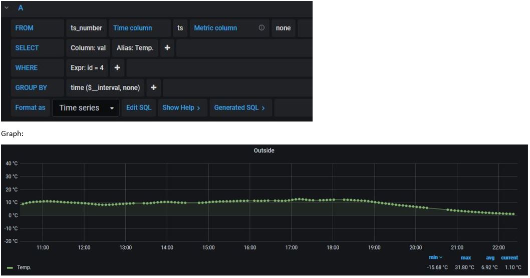

Problem:
The problem is that the values in the legend of the Graph do not adjust according to the selected time period. The min./max.avg. of all data is displayed.
How can I configure, so that the values adjust depending on the selected time period?
@jump2021 I’m fairly sure that the problem is that you have no time filter on your query. This means that the whole table is queried by Grafana regardless of the time range you’ve selected - meaning that Grafana is showing you the Min and Max over all time. You need to add Macro: $__timeFilter as part of the WHERE clause. Check out the examples in MySQL | Grafana Labs.
It has nothing to do with the Grafana version as long as you’re using a recent one; @habib1 is sending you on a wild goose chase.
Got it @jump2021 - I think this is what you need: on the line with the WHERE clause (where you currently have id=4 in your screenshot) click on the “+” button on the right to add a condition. The $__timeFilter condition should appear in the drop down - select that.
If you check out the screencast video just under MySQL | Grafana Labs you can see the time filter condition being applied in that user’s video. Hope that helps.

i found a soulution/example in the iobroker forum.
when i change the SQL-Query in Grafana to:
SELECT
ts/1000 as time_sec,
val as value,
“Temp” as metric
FROM ts_number
WHERE __unixEpochFrom() * 1000 < ts and __unixEpochTo() * 1000 > ts and id = 4
ORDER BY ts ASC
