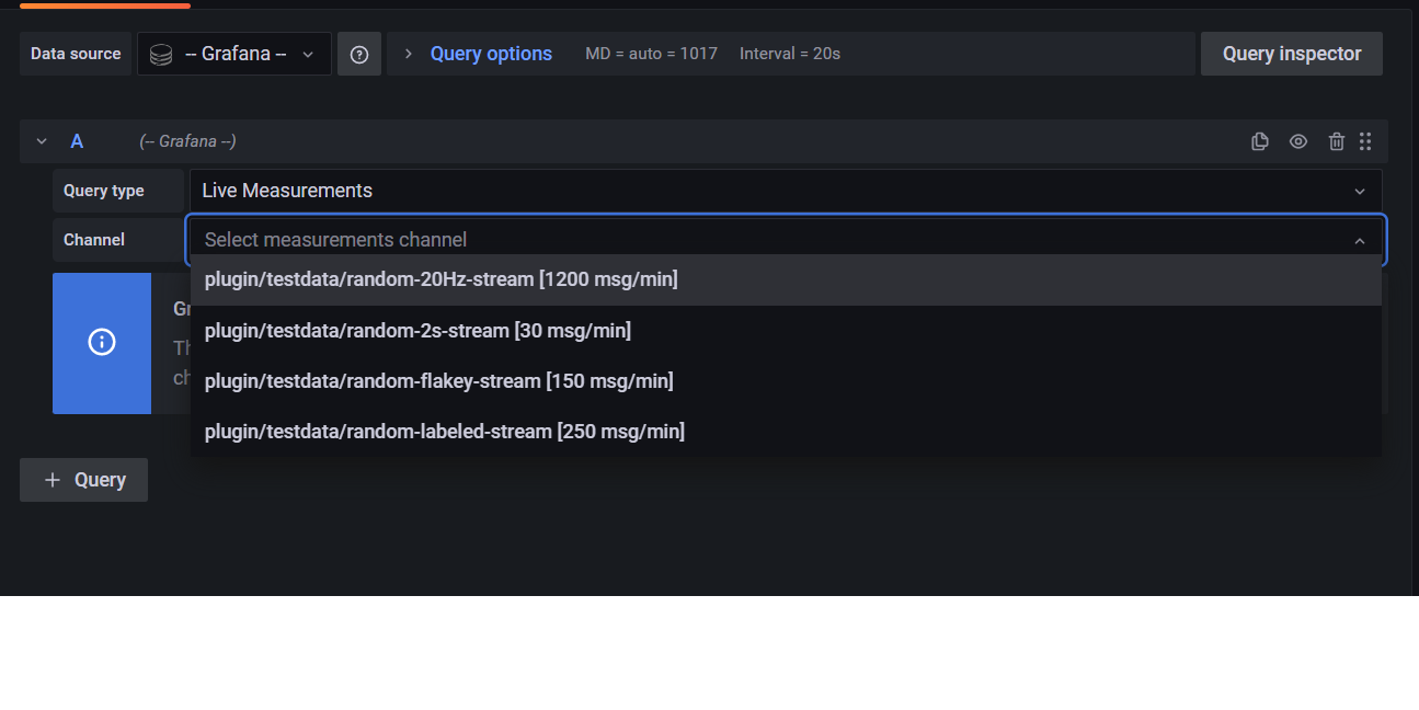

@skillDo as for your original post and question for any measurements coming through from the grafana live setup you should be able to see all the channels being published under the grafana datasource live measurement query type under the view as below:
if your streams dont show up then i would double check your telegraf setup since it can be a bit challenging to get it right sometimes

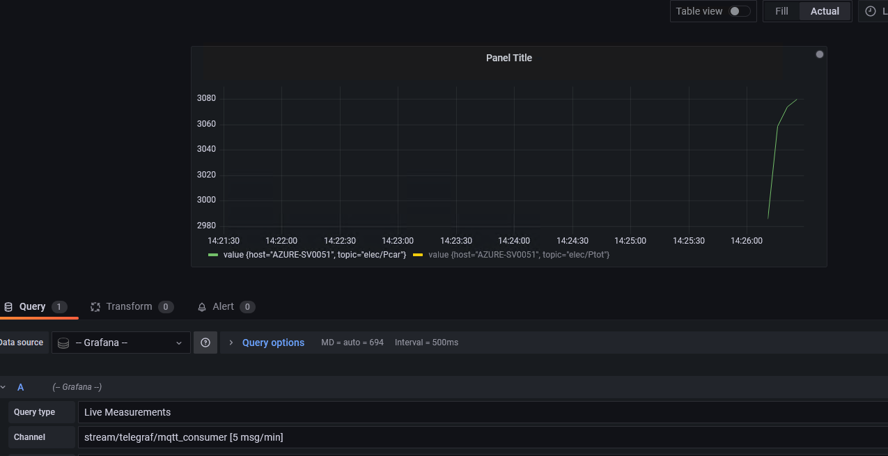

But I have another concern : I can see in this demo :
There are multiple different Topics aX, aY and aZ in the same panel
I can’t figure out how to have multiple : when I had a new query on a new topic, grafana panel display ‘value’ name twice and when I change the nane, It changes for both.

Also, I have run the same MQTT subscription using telegraf input mqtt consumer
and in this way, do you think it is easier to filter about topics in the SAME panel ?
