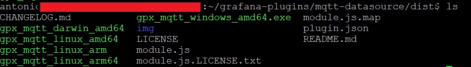

and here is the folder where i did the build and install along with path:

Here’s the mqtt-datasource/dist dir looks like

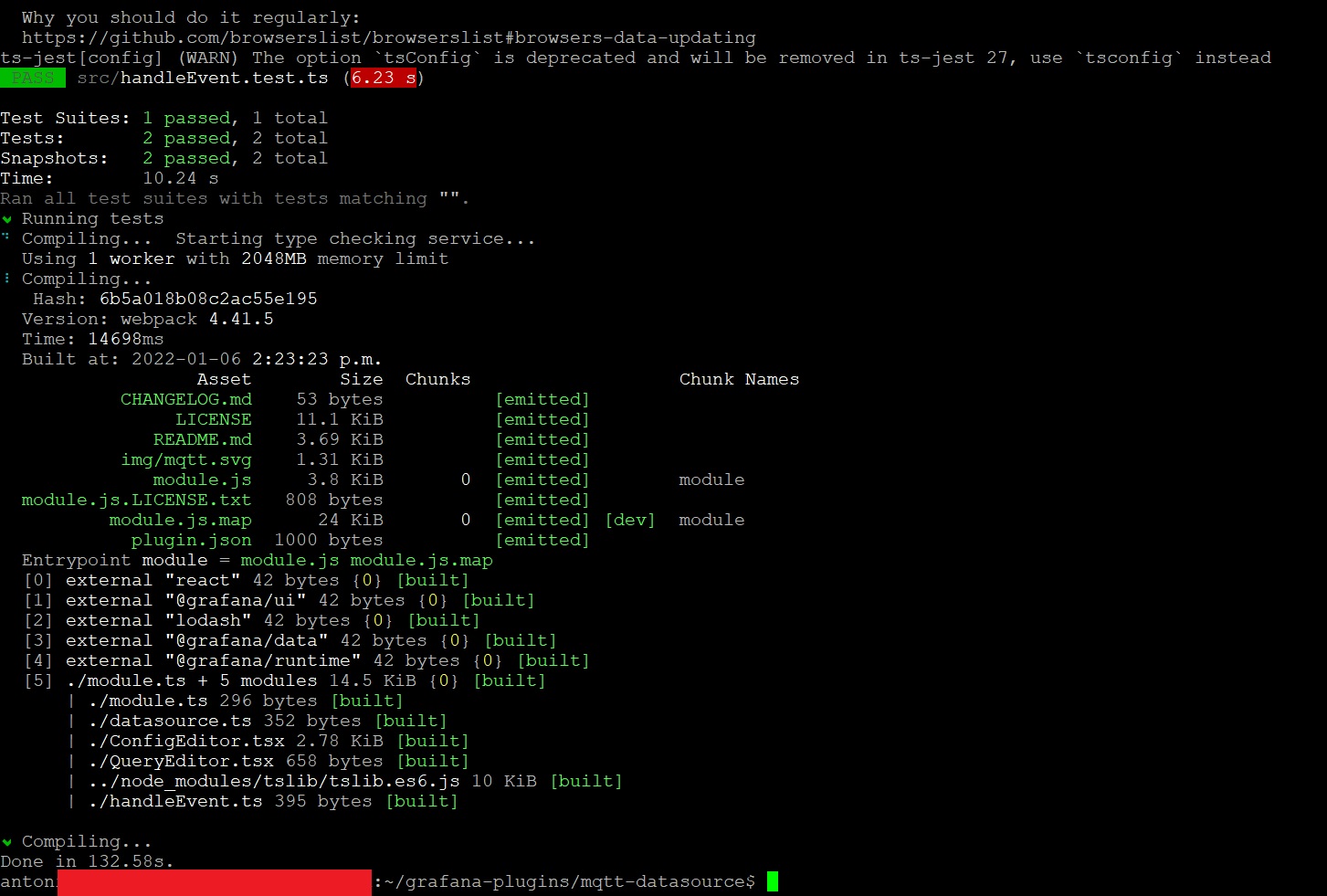

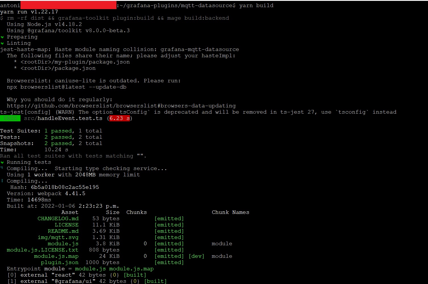

Here’s the yarn install output commands:
And here’s the yarn build commands

So i went the route to build the plug-in in the /var/lib/grafana/plugins directory.
$ mkdir grafana-plugins
$ cd grafana-plugins
$ git clone https://github.com/grafana/mqtt-datasource.git
$ cd mqtt-datasource
$ yarn install
$ yarn build
problem is, it complains now that mage is not installed (or found) when I ‘yarn build’ here’s the screen shots for both yarn commands:
