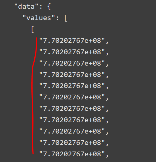

You have arrays there - open everything there and check values - don’t just high level - go deep into frames and data.
Sorry for that, here’s a fully expanded array of a single object:

So it looks like that scientific notation in string is returned from CW API and Grafana just shows it:
You may try:
  • Grafana transformations - transform ID field to number, then back to string - 2 transformations
  • Use Insights QL and achieve non scientific notation result - be creative - bling guess - contact with space string, …

Is there a possibility that this is a bug with the cloudwatch plugin? It seems that although the IDs are interpreted as a string, grafana receives them in a different format for some unknown reason.
How do you know that’s a bug in the CloudWatch plugin? Could you prove that AWS didn’t return that format? Did you try to ask your AWS support?
I have not discussed it with AWS support yet. I’m not sure if this is a legit bug, just thinking out loud if that could be a possibility. It’s basing on the fact that the same query shows different field formats on AWS side and Grafana side.
And I give you a fact that it looks like AWS API returns that when you check result in the query inspector. So you need to prove, e.g. use aws cli/curl and simulate that query from AWS console and prove that AWS returns data in non scientific notation. That you can say that it’s a Grafana’s issue.
Make that same API call outside of grafana using insomnia or postman and postback the results

No scientific notation visible here.
Correct, it’s visible that id is a field, not label, so it’s a metric value, not label/dimension from the Grafana point of view.
I guess Grafana loads it into float64 type, which has that scientific notation. It’s a Grafana issue, because AWS data model in the response is not vey suitable for Grafana.
Thank you for confirming my suspicions, I guess I will open an issue on github then, it would be nice to have this show up properly without any manual labor involved.
