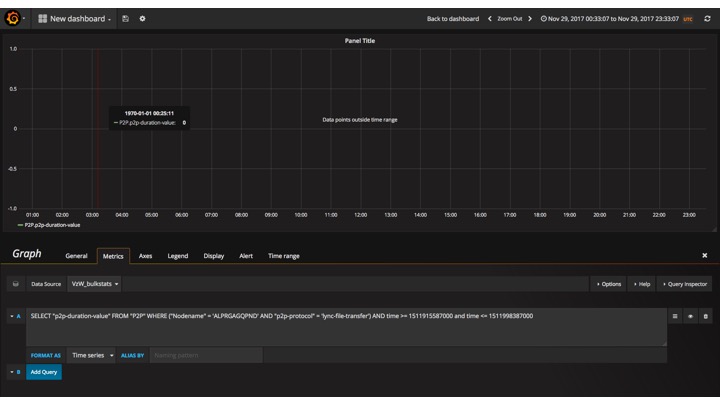

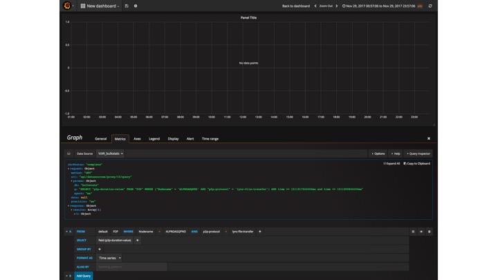

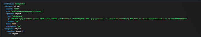

Hi Marcus,
Apologize for the huge screenshot, but I think what you’re looking for is all in there:
[/uploads/grafana/original/2X/8/81d3453ba7d5484cf37aa8b58224b73dc7a1bd25.png]
As you can see the range goes from 11am to 11pm, and my one datapoint is at 6:20pm but it’s not showing on the graph because the “ms” in the query.
If I run the exact same query manually in influx with out the “ms”, I get this:
SELECT “p2p-duration-value” FROM “P2P” WHERE (“Nodename” = ‘ALPRGAGQPND’) AND time >= 1511956025214ms and time <= 1511998153086ms
SELECT “p2p-duration-value” FROM “P2P” WHERE (“Nodename” = ‘ALPRGAGQPND’) AND time >= 1511956025214 and time <= 1511998153086
time p2p-duration-value
1511979600000 0
So you can see the “ms” query fails and the exact same query without the “ms” works.
To answer your second question, yes I believe if Grafana did not include the “ms” then the query would work and the data point would show up on the graph. But I can’t test that because I don’t know how to omit that “ms” through configuration. I tried looking at the source code but i’m not a Go expert and couldn’t really figure out where that “ms” was being added to the query string. Maybe if it was configurable it would help (ie user can choose to either include or omit the “ms”)?
Thank you,
Dan Musca
Cisco High Touch Technical Support
Phone: 469-255-3768
Cell: 972-768-0937
Email/Jabber: dmusca@cisco.commailto:dmusca@cisco.com
HTTS Hotline: 800-495-9121
To update your case: Cisco
Cisco Worldwide Contact: Cisco Worldwide Support Contacts - Cisco

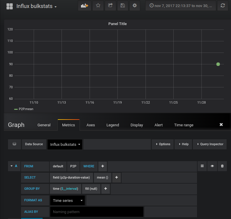

Hi,
I can see the screenshot now :+1:
Since you only have one data point I think you need to display the graphs as points instead of lines. Please try that.
Marcus

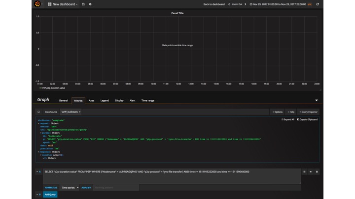

Hi Marcus,
I changed it to Point and still no luck (see attached…one screenshot shows I select Point and the other shows the formula).
Also, the output of the Grafana command when run manually on influx:
use bulkstats
Using database bulkstats
SELECT “p2p-duration-value” FROM “P2P” WHERE (“Nodename” = ‘ALPRGAGQPND’ AND “p2p-protocol” = ‘lync-file-transfer’) AND time >= 1511915587000 and time <= 1511998387000
1511979600000 0
I’ll try adding a few more datapoints a few seconds apart to see if that helps. Can you think of anything else?

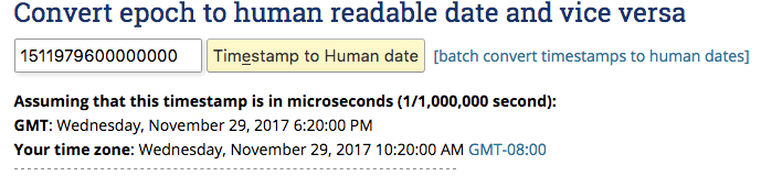

While poking around some more I noticed something odd. When I remove the “ms” from the time range using manual edit, then mouse around the chart area it seems to think it’s 1970 (see attached), even though the selected date range is Nov 29 00-23hrs. That could explain why it thinks the data points are out of range.
What do you think?

Marcus,
I’m not sure what you mean. If I use “ms”, the entire query will fail because influx doesn’t find anything when I use “ms” in a manual query.
I tried specifying 1970 in the time range but didn’t see anything in the graph, which makes sense because the data points in influx are all Nov 29.
But then I added 10 data points starting at 00000000000000 (1970-01-01) and when I specify the same time range (ie 1970-01-01 00:00:00), I see the data on the graph.
Do you think this is a bug?

1000000 ALPRGAGQPND 0 10 lync-file-transfer <<< timestamp starts Jan 1 1970 00:00
2000000 ALPRGAGQPND 0 20 lync-file-transfer
3000000 ALPRGAGQPND 0 30 lync-file-transfer
4000000 ALPRGAGQPND 0 40 lync-file-transfer
5000000 ALPRGAGQPND 0 50 lync-file-transfer
6000000 ALPRGAGQPND 0 60 lync-file-transfer
7000000 ALPRGAGQPND 0 70 lync-file-transfer
8000000 ALPRGAGQPND 0 80 lync-file-transfer
9000000 ALPRGAGQPND 0 90 lync-file-transfer
1511979610000 ALPRGAGQPND 0 10 lync-file-transfer <<< timestamp starts Nov 29 2017 6:20pm

  1. Now go to Grafana and look for the data points (see slide 1 for output). Result “No data points”.
  2. Run query manually from Query Inspector (nothing is returned)
SELECT “p2p-duration-value” FROM “P2P” WHERE (“Nodename” = ‘ALPRGAGQPND’ AND “p2p-protocol” = ‘lync-file-transfer’) AND time >= 1511917026000ms and time <= 1511999826000ms
  1. Run same query but removing “ms” from timestamps
SELECT “p2p-duration-value” FROM “P2P” WHERE (“Nodename” = ‘ALPRGAGQPND’ AND “p2p-protocol” = ‘lync-file-transfer’) AND time >= 1511917026000 and time <= 1511999826000

And I can see the value written in Grafana:
Please try this out and let me know if that solves your problems
