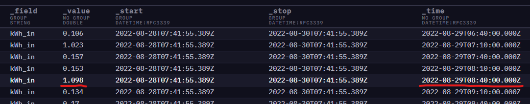

I have electricity consumption data in InfluxDB v2.4.0 which I want to view with a Time Series in Grafana v9.1.1.
This is a snip showing the raw data in InfluxDB:
I’ve highlighted the value of 1.098 kWh at 2022-08-29T08:40:00.000Z.

i think i understand :
On this screen you can see :
You have data every half hours in influxdb
on this screen you can see you have indeed data every half hours in grafana :
but with UTC +1 it will add one hours to all time value
|> aggregateWindow(every: 30m, fn: mean)
you do not need offset. i think weirdness come from here and the fact you have data on each Hours + 10 min and hours+ 40 min
If you did not resolve this, i’ll take time tonight to do this at home
If I use
it actually shifts the 1.1 kWh value to 10:00 instead of 09:40… so even further away from what it’s supposed to be! I added the offset: -20m when I was playing with aggregateWindow() to bring it back to the right time.
I sure am confused by this!
please post your current time from your clock and UTC current time side by side
also how are you pushing this data into influxdb?
if via telegraf, where is that running?
where is your influxdb located? on what server , what tis the time on that influxdb server?
please show us also the code that is writing to influxdb
somewhere in that mix we can sort out the issue
My server: 18:00 (UTC+01:00, Europe/London)
UTC: 17:00
Using Node-RED, I make an HTTP request to an online service that provides my energy consumption in JSON format:

I then use a function node to process this data into a format suitable for InfluxDB 2:
    "measurement":"electricity_supply",
    "fields":{
      "kWh_in":0.148
    "tags":{
      "type":"electricity_consumed"
    "timestamp":1661733000000000000

I then use an influx batch node to send this data to InfluxDB.
Looking at the formatted data that is sent to InfluxDB, the timestamp associated with a kWh_in value of 1.098 is 1661761800000000000 (in nanoseconds), which translates to Monday, 29 August 2022 09:30:00 UTC+01:00. So the processing in Node-RED seems to be correct.
InfluxDB, Grafana and Node-RED are all running in separate Docker containers on the same physical server.
  • Server timezone is UTC+01:00 (my local time)
  • InfluxDB container’s timezone is UTC
  • Grafana container’s timezone is UTC
  • Node-RED container’s timezone is UTC+01:00. I don’t know if you’re familiar with Node-RED, but if I tell it to output $now() it returns 2022-08-30T17:00:00.000Z, which is the correct UTC.
The data seems to get into InfluxDB absolutely correctly, as the timestamps all match. There seems to be some discrepancy between InfluxDB and Grafana…
Thanks for your efforts!
Chris
ohoh maybe there is a disturbance in the space time continuum where you are at. you are 10 minutes behind!!! :scream: :running_man:
ok will load your data on my influxdb and see what is up.
I checked the data again this morning, after Node-RED loaded a new batch into InfluxDB, and the times have all changed from :10 and :40 to :00 and :30, and now everything is working exactly as it should :man_facepalming:
I am really sorry to have wasted people’s time on this - it definitely looks like it was initially an issue with the data provided by the energy monitoring service, possibly due to my only signing up with the service a day before finding this issue with the timestamps.
All the best,
Chris
