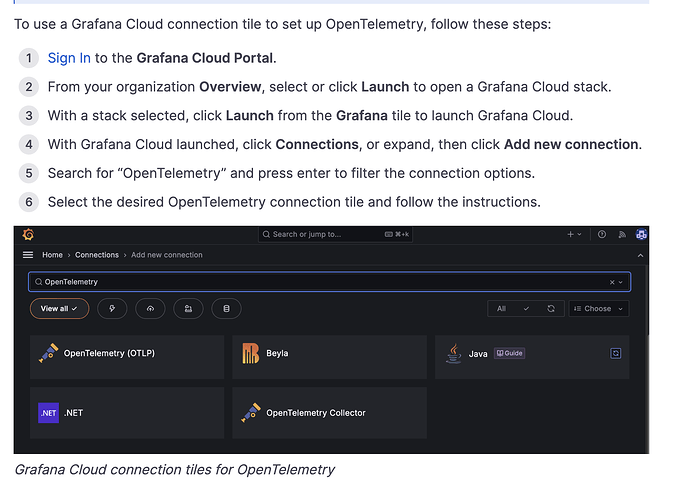

I’m also using hetzner. My exact reproducible steps from a clean install of a Ubuntu 24.04.1 LTS:
I followed these steps:
  1. Clicked on this page Instrument a Node.js application | Grafana Cloud documentation . I updated
    OTEL_RESOURCE_ATTRIBUTES: "deployment.environment=${DEPLOYMENT_ENV},service.version=${IMAGE_TAG:-latest},service.instance.id=${HOSTNAME}" and this is only deviation from that page
  2. I checked out “Next steps”. I created a free Grafana cloud and went straight to step 3. “3. For production, set up an OpenTelemetry Collector”
  3. In “Grafana alloy” section of the page it says “Consult the Grafana Alloy documentation”
  4. I clicked that link and I checked “Recommended setup” section of the page, which again linked to another resource: “Grafana Labs recommends instrumentation of the OpenTelemetry (OTLP) with Grafana Alloy Grafana Cloud integration tile to configure Alloy.”
  5. So I clicked to see how can I add this “integration tile”
  6. I followed the steps on that page
  7. This leads to this

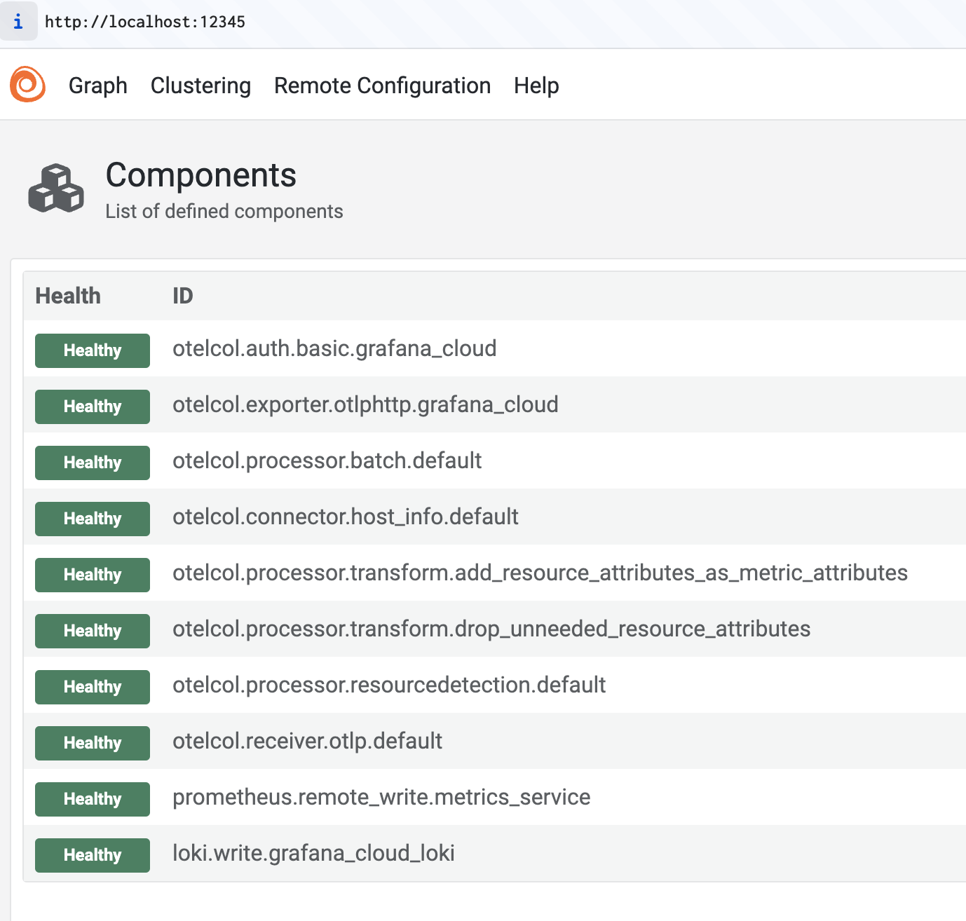

  8. Service is up and running on the machine
mario@Ubuntu-2404-noble-amd64-base:~$ systemctl status alloy
● alloy.service - Vendor-agnostic OpenTelemetry Collector distribution with programmable pipelines
     Loaded: loaded (/usr/lib/systemd/system/alloy.service; enabled; preset: enabled)
    Drop-In: /etc/systemd/system/alloy.service.d
             └─env.conf
     Active: active (running) since Tue 2025-04-08 11:42:56 CEST; 20min ago
       Docs: https://grafana.com/docs/alloy
   Main PID: 3383552 (alloy)
      Tasks: 17 (limit: 76975)
     Memory: 51.2M (peak: 52.0M)
        CPU: 3.107s
     CGroup: /system.slice/alloy.service
             └─3383552 /usr/bin/alloy run --storage.path=/var/lib/alloy/data /etc/alloy/config.alloy
  1. curl is working. service is healthy
mario@Ubuntu-2404-noble-amd64-base:~$ curl -X POST https://prometheus-prod-24-prod-eu-west-2.grafana.net/api/prom/push \
  -u ID:GLC_KEY \
  -H "Content-Type: application/x-protobuf" \
  --data-binary @/dev/null
getting snappy decoded length: snappy: corrupt input
mario@Ubuntu-2404-noble-amd64-base:~$ curl -X POST https://logs-prod-012.gramario@Ubuntu-2404-noble-amd64-base:~$ curl -X POST https://logs-prod-012.grafana.net/loki/api/v1/push \
  -u ID:GLC_KEY \
  -H "Content-Type: application/json" \
  -d '{}'
error at least one valid stream is required for ingestion
mario@Ubuntu-2404-noble-amd64-base:~$ curl http://localhost:12345/-/ready
curl http://localhost:12345/-/healthy
Alloy is ready.
All Alloy components are healthy.

Visting UI on :12345 port also says everything is healthy
