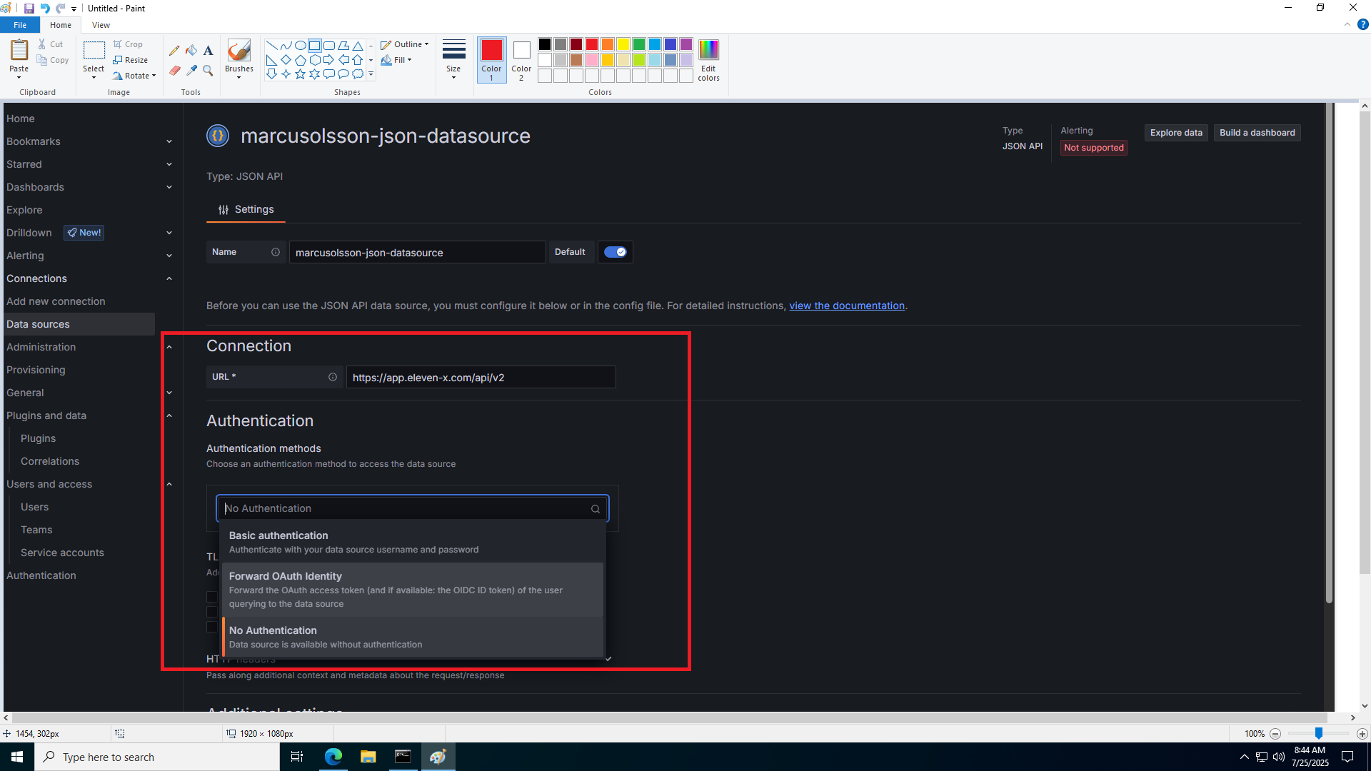

Hi Shanker,
I cant find the Header option in your step # 3
You can find the Header section just below the TLS Settings

I tried again using the header in your step #3. Under Authentication, I selected ‘No Authentication’ and then entered the following under the HTTP header fields: I pasted the token key text inot the Value. When I did a Save & Test, I got the error message shown below.
