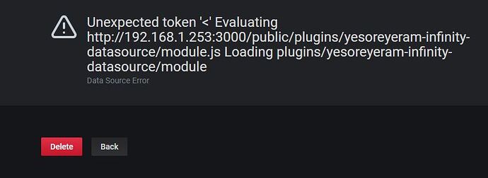

Hi, im new to grafana, and try out the sriram plugin but an error comes up
Currently simple username/password or any header based tokens supported.
