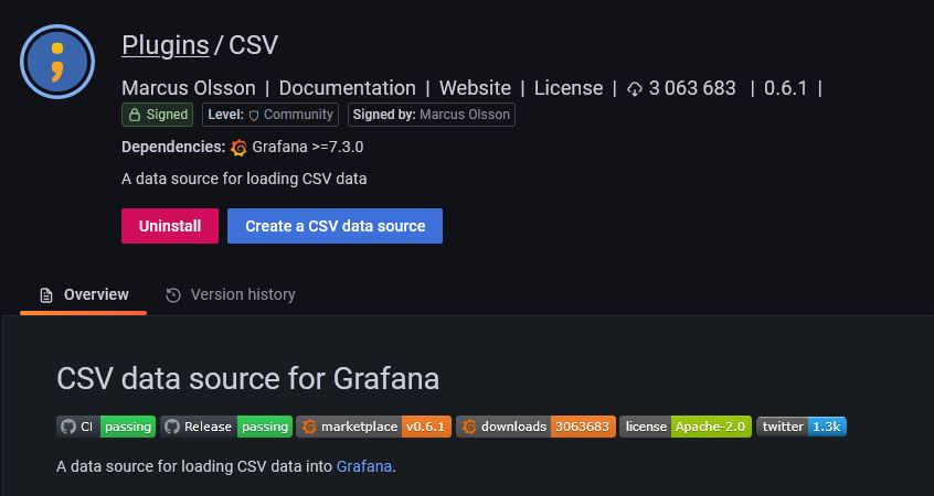

Also which csv plugin are you using?
I added those lines in default.ini of the following directory :C:\Program Files\GrafanaLabs\grafana\conf.
And i used this csv plugin :
it seems like you have installed it but have not yet created a data source?

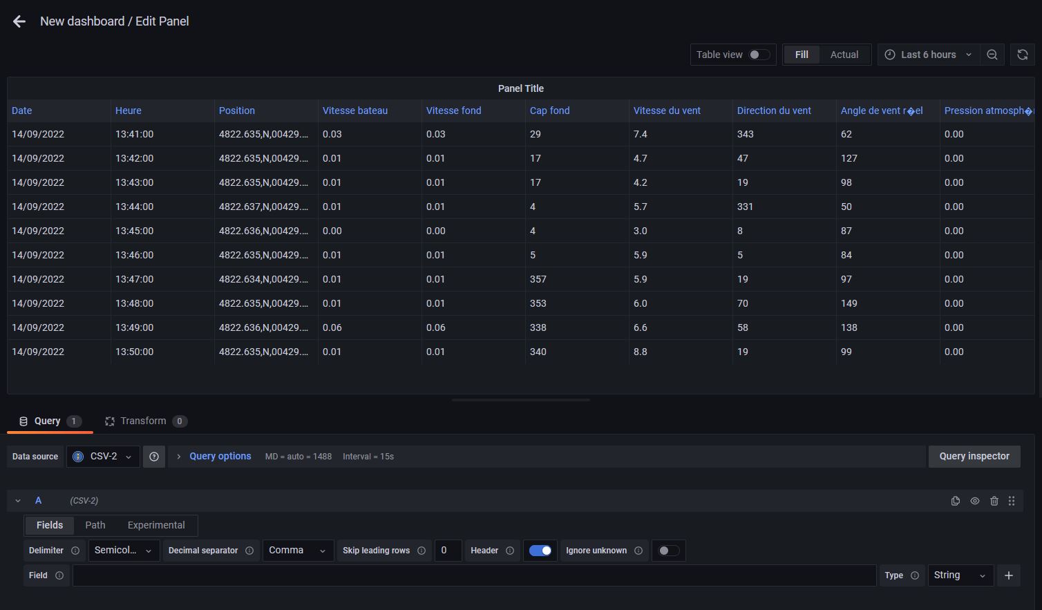

I created the datasource with the following path: C:/Users/Public/Grafana/journalR.csv
But when I try to use it in my dashboard, it shows me this:
let me try it locally. what version of grafana do you have? @Seji
I have grafana OSS 9.1.4.0.
It’s good, I no longer have a problem, I have the table with the values ​​displayed.
