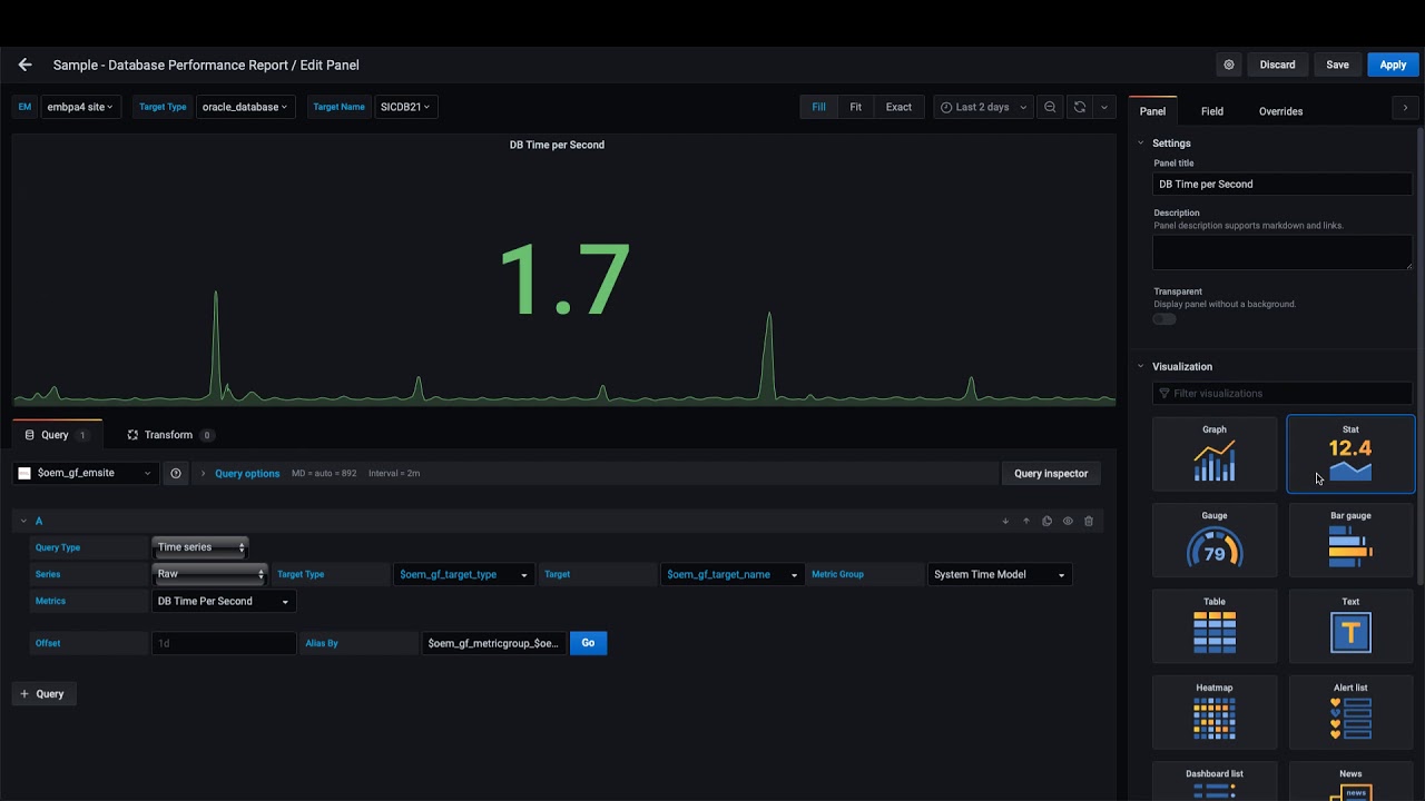

I have queried a production database thru OEM. All metrics are gathered in OEM repository and are visible in OEM Cloud Control. But if I try to request them using grafana they are limited to 10 objects.
Oracle Enterprise ManagerCloud Control 13c
Grafana v7.3.5 (11f305f88a)
Grafana Plugin version 2.0.0
"request:Object
url:“api/datasources/proxy/4/em/websvcs/restful/grafana/v2/query”
data:Object
range:Object
targets:Array[1]
pluginVersion:“2.0.0”
grafanaVersion:7.3
isRemoteConnection:false
method:“POST”
hideFromInspector:false
response:Array[10]
Already checked Application API Throttling but with no results. Any clue? Where are the limitations?

no error message. Oracle doesn’t support this plugin officially, I put a question on their Grafana plugin community forum …
Have you checked the Series: Custom (Repository) in your metric definition in Grafana ? I can see that in your case isRemoteConnection:false, though I would have expected this to be a Remote Repository for Grafana to query the OEM Repository.
