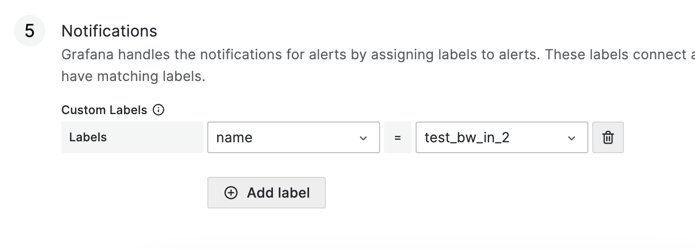

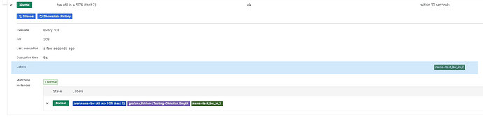

What I mean is looking at the logs and screenshots I think you had both a label called name from the InfluxDB query and a custom label called name at the same time.
I’ve highlighted in blue the custom label called name that would have been conflicting with the name label from the query.
You can delete this using the Trash can icon under Custom Labels:
Hi @georgerobinson … I just don’t believe that is the case. In order to get the alerts to work, all I changed was the tag i was grouping by in the first query of the alert rule. I did not change anything else.
As you see, I use the “name” label in the alert rule simply to route the alert…and i am still using that label. The alerts work fine even if I have that label.
