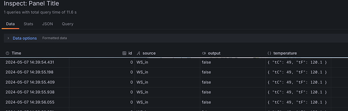

Suppose you have this messagge as resutl from a subscription from “device/status”:
    "id": 0,
    "source": "WS_in",
    "output": false,
    "temperature": {
        "tC": 49.0,
        "tF": 120.1
Then from dashboard if I set the subscription topic to “#” and go to Query Inspector and see the data incoming:
My questions are:
  1. why if I set the subscription topic to device/status no data are shown at all?

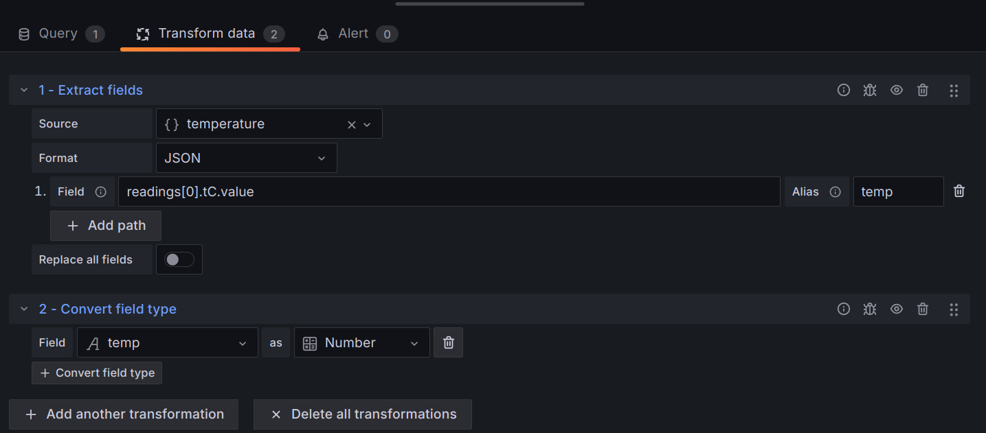

  2. how could I get the temperature.tC vaule? I’ve tried this transformation without success
try with the format of auto
Thanks for your reply, I’m reading the documentation but cannot find anything related: Query and transform data | Grafana documentation
Can you please explain what you mean with “the format of auto”?
Thank you very much that’s it!
