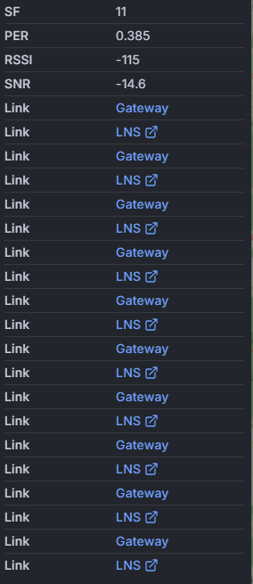

Links repeated several times with same content
I use Grafana in the Community Edition.
On some geoMap panels, I use data links to refer from the displayed marker layers to other dashboards and pages.
Until about two weeks ago, the links became visible on mouse-over and worked.
Link1
Link2
Link3
I’m not sure if this is related to an update, but then the links suddenly appeared multiple times.
Link1
Link2
Link3
Link1
Link2
Link3
Link1
Link2
Link3
I can’t figure out why. All links work exactly as before, but it’s visually confusing. Sometimes a link is repeated 5 times. On another page, there are 3 links and each is displayed 6 times. Sometimes there are only 2 repetitions.
I can rule out that any settings have been changed. In the Grafana basic settings, I have only entered the Postgres DB that I use. And there are a few users. The server is a Debian 12.
I have found posts on the internet that describe this behavior (some of them more than a year old). But I haven’t seen a solution to it. At the time, it was assumed that it was a bug that would be fixed with an update.
Is there any other/newer information on this?
Hey, I’m having the same issue as you. Did you get to solve this?
The newest update solved it for me.
Is the newest version you’re referring to 12.2? If so, that’s when the problem started.
For me it’s 12.2.1 now.
