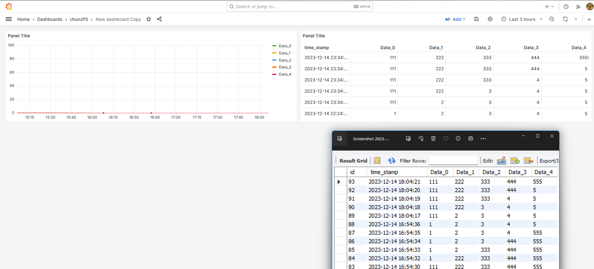

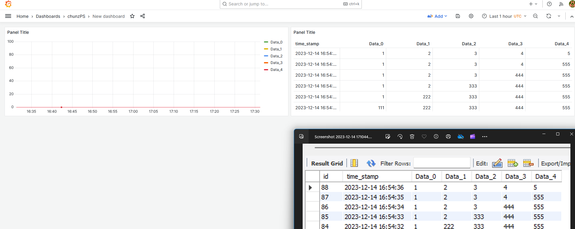

    When i manually define the time-range for e.g., “2023-12-14 16:54:23 to 2023-12-12
    16:54:36”, then data is shown correctly on Line-chart and x-axis(time-axis) is also correctly shown.
  • What created problem?
    However, if i change the time-range to “last 15 minutes/30 minutes” …, then my line chart in this case is shifted by 05:30hr behind. This problem is limited to line-chart only
  • What did i tried?

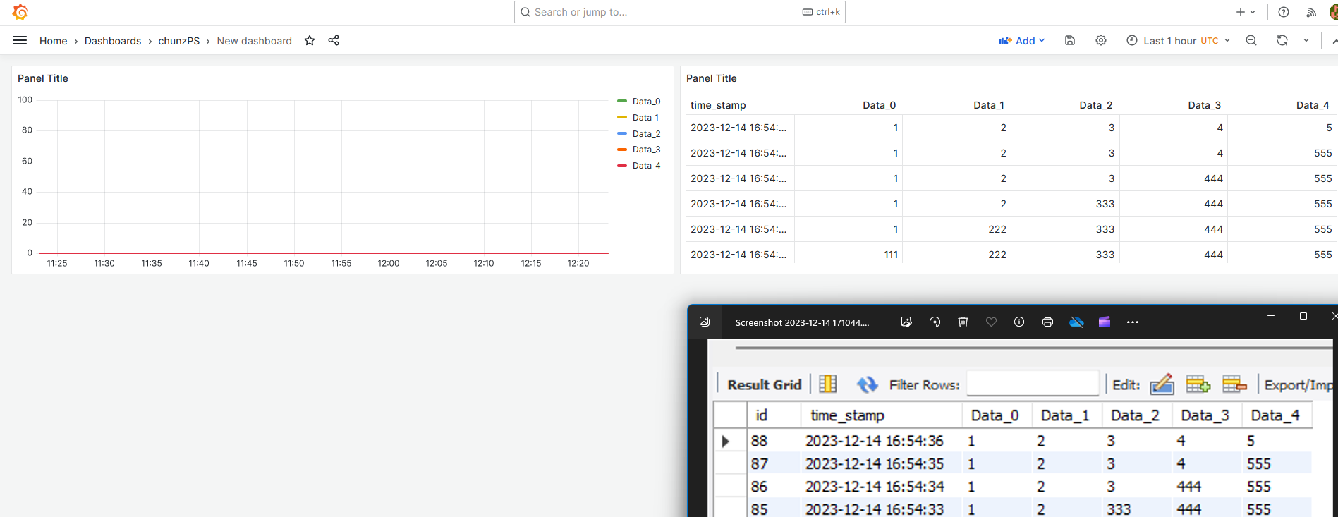

    I configured the time-zone to UTC +05:30 inside Line-graph(edited) which now correctly shows the time in x-axis in line chart[as visible in image]. But problem is that no data is showing.
Using the gear-icon in the Grafana dashboard, i changed the time-zone to “UTC +05:30” which correclty set the time-axis of line-chart only but no-data is visible and also misconfigured the time-column of tabular chart moving it forward by -05:30hr i.e., [see image].

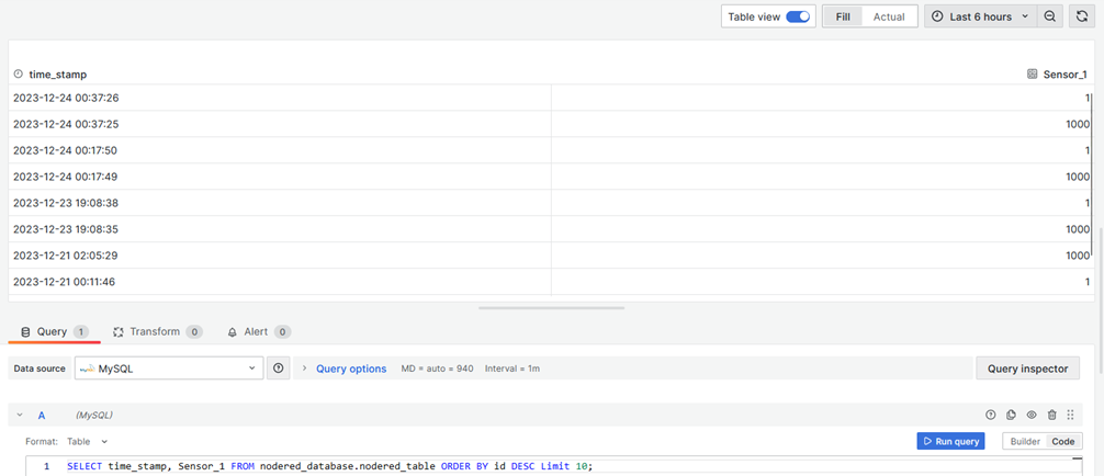

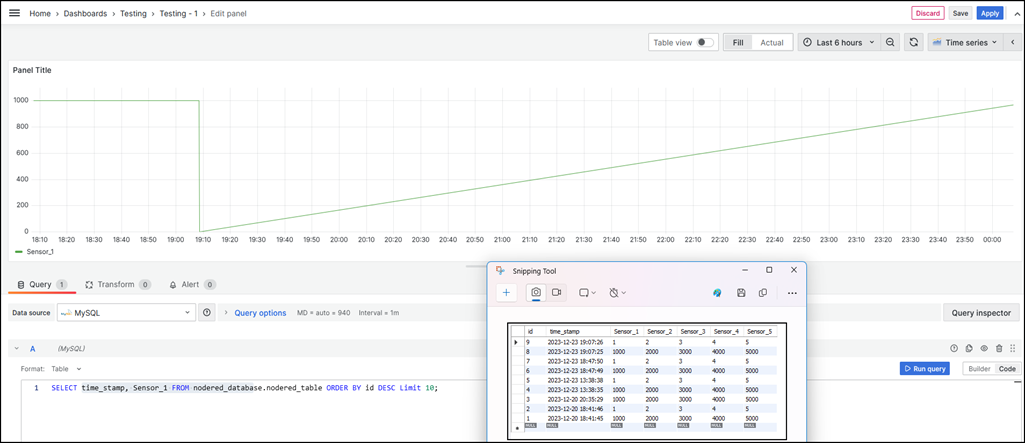

Step-3) Next on the dashboard screen, choose line-chart[example as shown below]. As its visible, time-stamp(along x-axis) and variable(along y-axis) is currectly matching the value as per MySQL workbench table. However, there is one problem that Line-chart is continuously running beyond the time “19:07:26” even though our MySQL database table is upto time “19:07:26”[as shown in image-1]. Also, if you click on “Table view”, you’ll find that timestamp data is +05:30hr ahead [as shown in image-2]. To remove this error, follow next-step.

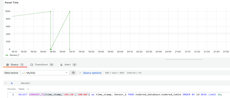

Step-4) To remove this error, you have to make use of CONVERT_TZ function which not-only corrects the line-chart but also corrects the table data as well [as shown in the image]. Here, this function will shift the time-stamp values behind by 05:30hr. As a result, Our Line-chart as well as tabular data both will be corrected.
Step-5) Also, make sure that timezone in timerange of dashboard screen must also be changed to ‘UTC+05:30’ as shown in image.
