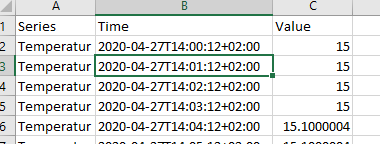

i made a screenshot from the database and the csv export from grafana graph
i´m not a profi so im thankful for your help
excel

In the excel image you posted earlier you showed, for example, 2020-04-27T14:01:12+02:00 is 14:01 the correct local time, and the timezone is gmt+2?
yes - also in phpmyadmin the timestamp is correct - when i use function for utc timestamp then the time switch to utc and grafana is working fine - but i have to do this for all entrys thats not possible to do this
