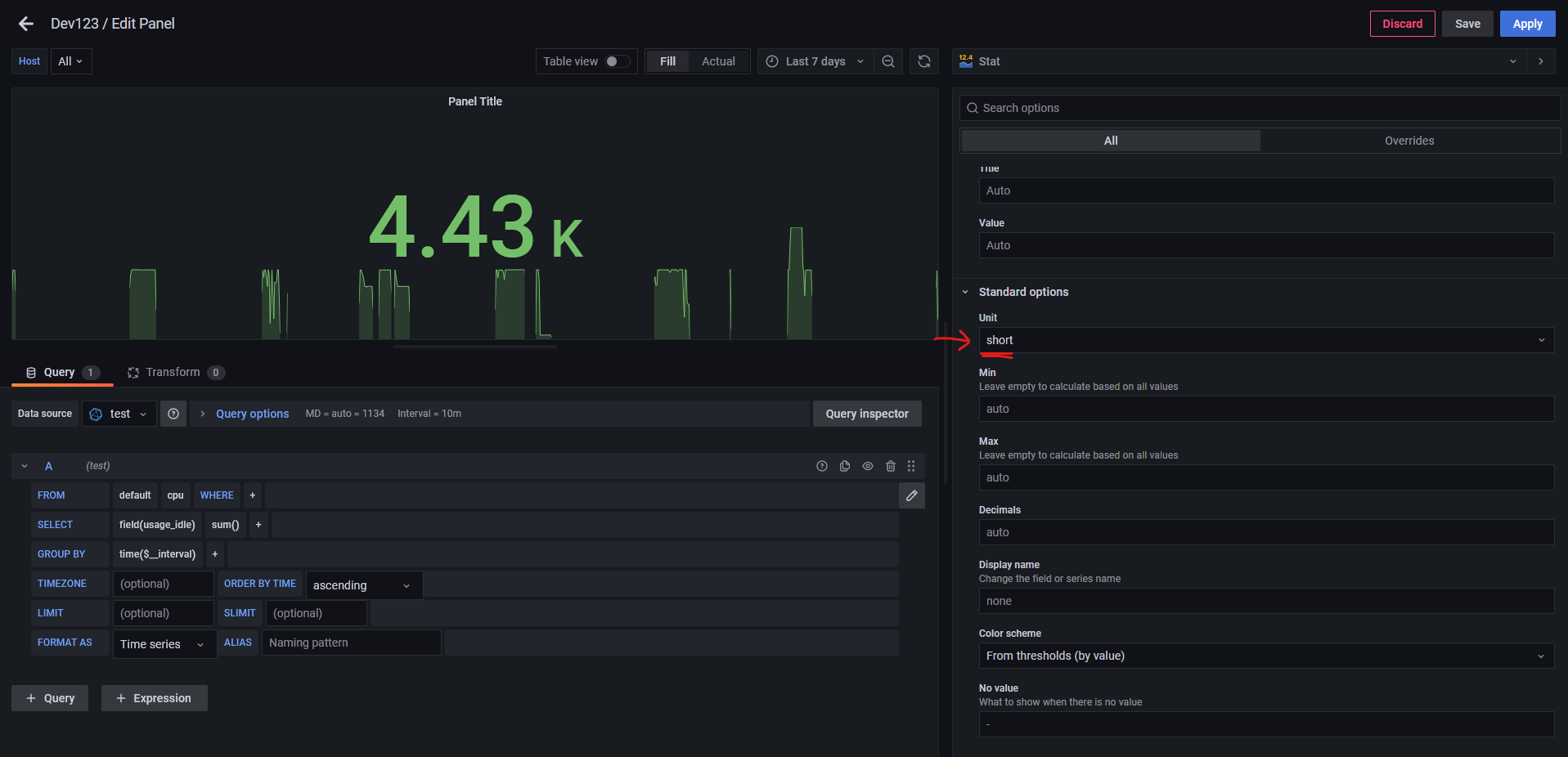

Hi @knherzog,
You should change metric unit from short to number inside panel and then panel will show full numbers. You can also set desired number of decimals.

Thanks, but I have it on Currency-> Euro. If I change it to numbers, I loose the € symbol.
I wonder if data type currency should use the k sign for thousands. It is not a bug, but an unusual behaviour for currencies in my opinion.
Aha! Try using custom unit - just type € into unit field and you would have € symbol after metric and grafana won’t do any calculations over metric (opposed to Currency / Euro € unit).

Hi,
I just wanted to add that custom units can be added as suffix to values with:
suffix: €
You can even add emoji as custom unit. For copying emojis I found https://emojipedia.org/ useful since you can search for emojis and just click on copy and paste it to unit field in Grafana.

And if you want it to be in front of the data, you can use:
prefix: €
