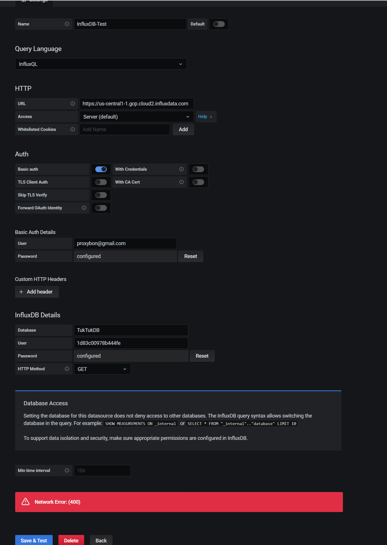

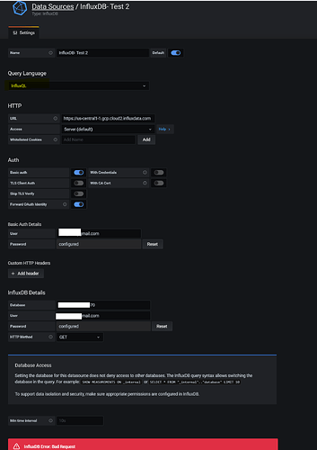

Hi,
I’m using Grafana Cloud and InfluxDB Cloud
On Grafana - I’m creating datasource connection
Details used for creating connection string
Query Language: InfluxQL
URL: https://us-central1-1.gcp.cloud2.influxdata.com
Basic Auth
Username: xxxxx@gmail.clom
Password: I created a token and used it.
Forwarded OAuth
Error: BadRequest… Not sure what is wrong…
Appreciate all the help I can get…

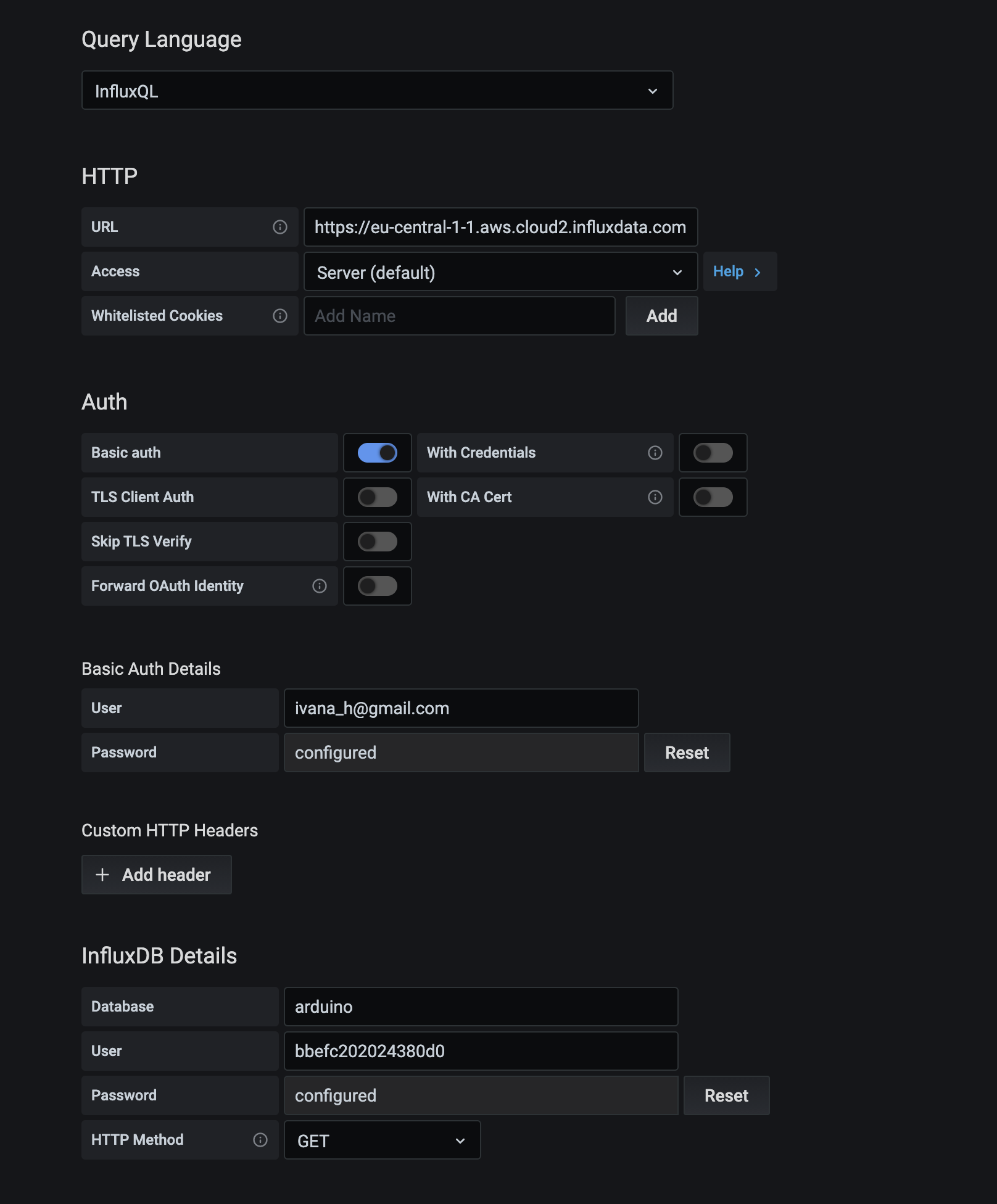

Hello @proxybon for cloud2, the user in InfluxDB Details on the bottom should be id of the organisation. So for example, in my case (see below) it is bbefc202024380d0. And the database is the default bucket.

Still the same… I even tried adding header but the error continues to be same…
Added Header and tried based on this link
Would you try to switch User in BasicAuth to the users (your) email? And for password keep the generated token. I don’t think you need Custom HTTP Header. And then in InfluxDB details, database is the bucket’s name, user is the org id and password is the token.
Also, I tested/tried this based on this documentation directly from InfluxDB on API compatibility of InfluxDB2 with InfluxDB1: InfluxDB 1.x compatibility API | InfluxDB OSS 2.0 Documentation. Generally for cloud2, setting up with Flux is much easier and more straight forward, as you can see there clearly what is expected:

InfluxDB Details
OrgId as UserName: 1d83c00978b444fe
Token:
HTTP Method: Get
Removed - Header…
But still same error… :frowning:
OrgId
Would you mind trying it at your end… I will create a temp token and share it… just to isolate that its not me :slight_smile:

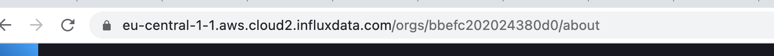

So just 1 last check if we have everything configured in the same way:
Basic Auth:
User: your user id (but not the id number, the user id name) that you can find in /about
Password: active token created in load-data/tokens that has access to specified bucket
InfluxDB Details:
Database: name of you InfluxDB bucket that you want to use in load-data/buckets. Keep in mind, provided token has to have read access to that bucket.
User: org id that can be found in /about
Password: active token created in load-data/tokens that has access to bucket

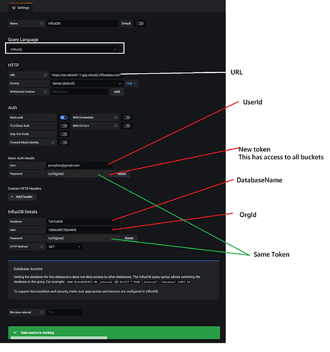

Again… thanks for holding on.
I have created using Flux - this works brilliant and I’m able to query it.
InfluxQL… Datasource connected but doesn’t show any database…
Reason why I wanted to use InfluxQL is to use my exisiting SQL skills…

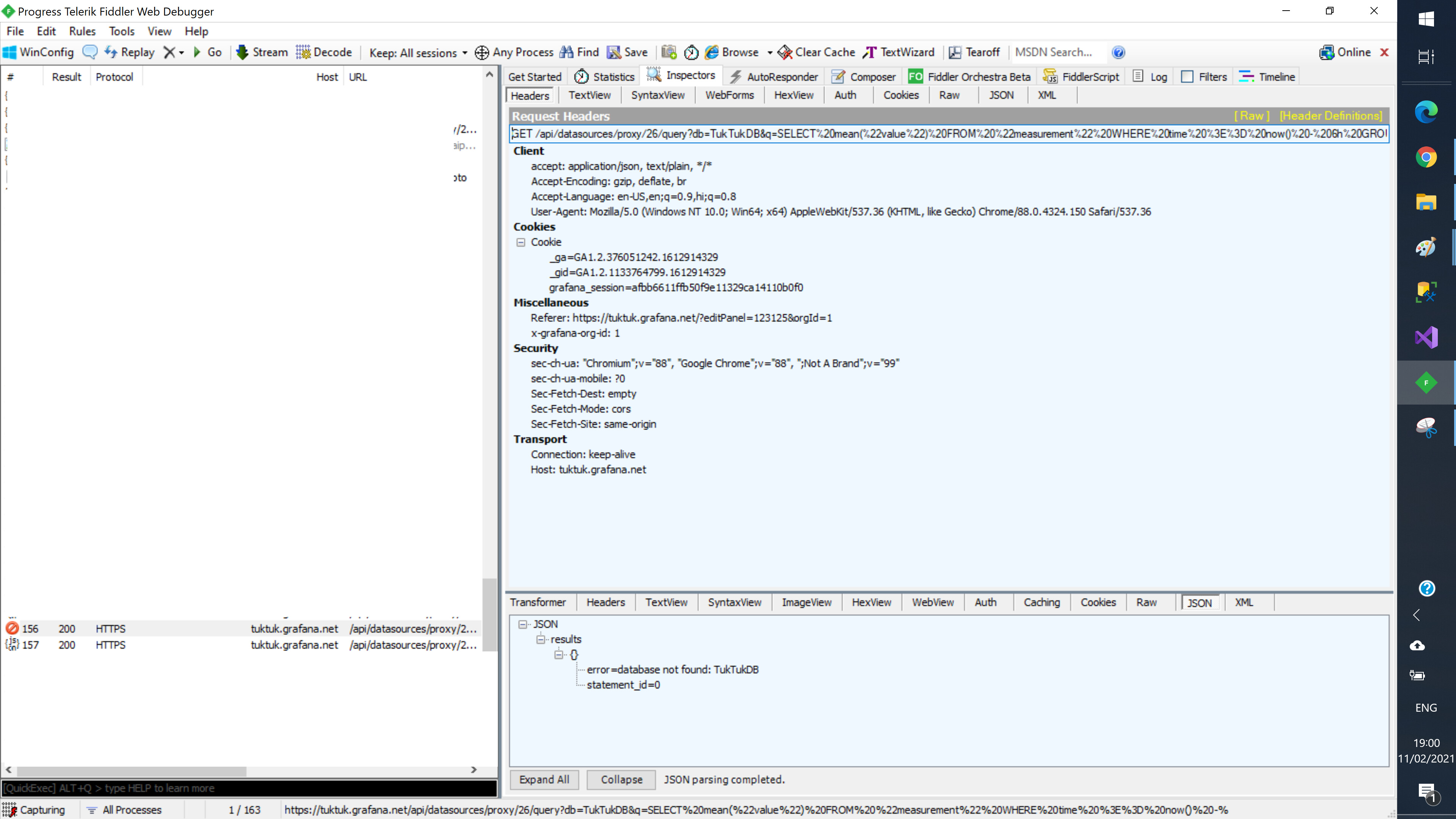

Here’s what i tried
Fiddler details
Same when I try with Flux it shows that it found 3 buckets
