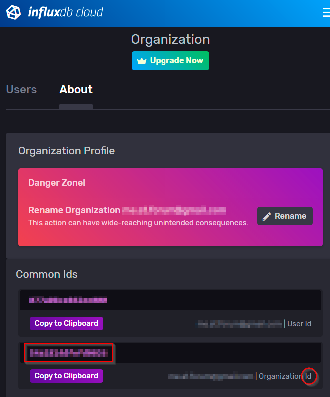

@familiepiroth If you want to setup Influxdb v2 with Flux, you need to change url to just https://eu-central-1-1.aws.cloud2.influxdata.com/ and then for organization, use the org id that can be find in the url. See below my example:
thanks, that was the crucial part. maybe it should have been made more clear that the configuration expects organization id and not organization name
Yeah, I also confirm that this is the crucial part of the puzzle!
After specifying the ID instead of the name as implied by the description
It is connected well
Thanks. This solved it for me.
