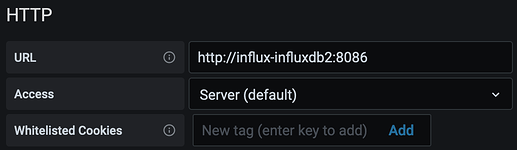

Configure Datasource
I’ve exported the admin token by using this command:
kubectl get secret influx-influxdb2-auth -o "jsonpath={.data['admin-token']}" --namespace monitoring | base64 --decode ; echo

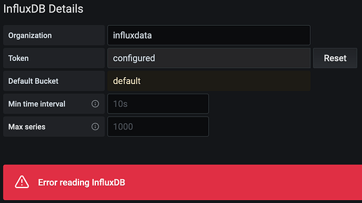

The Grafana instance logs this error
t=2021-05-16T12:11:52+0000 lvl=warn msg="Flux query failed" logger=tsdb.influx_flux err="unauthorized: unauthorized access" query=buckets()
t=2021-05-16T12:11:52+0000 lvl=info msg="Request Completed" logger=context userId=1 orgId=1 uname=admin method=POST path=/api/ds/query status=400 remote_addr=10.42.0.1 time_ms=45 size=798 referer=https://grafana.sample.domain/datasources/edit/4/
While Influx logs this:
ts=2021-05-16T12:11:52.982455Z lvl=info msg=Unauthorized log_id=0U2QEkrl000 error="authorization not found"

After several attempts, and investigating the request that the grafana sends, I saw that in the standard authentication model he was giving a bad request and receiving a timeout.
So putting together some tips from this thread, it worked that way.
Query Language: Flux
URL : http://localhost:8086/
Access : Server (Default)
Do not select any Auth items
Custom HTTP Headers:
Authorization : Token + (Token) “obtained on date> Tokens> token”
InfluxDB Details
Organization : (organizationId)
Token : (Token) “obtained on date> Tokens> token”
Default Bucket : your default bucket
min Time: Default
max time: Default

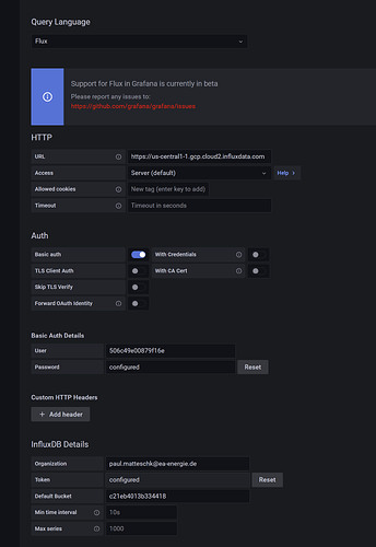

Okay i found two solution. First one this:
You can use it if you keep using InfluxQL
If you want to use Flux here is my configuration
URL: http://localhost:8086
Acces: Server (default)
Whitelisted coockies: (don't touch)
Auth
(don't touch)
Custom HTTP Headers
Header: Authorization
Value: Token aaabbbcccc
(the aaabbbccc is the token you find in Data > Tokens admin's Token, I think it is possible to create another member to secure the acces)
Organization: the_name OR the_id (it doesn't really matter)
Token: (same token who was given in value without the word Token in front)
Default Bucket doesn't matter

Hi bbortolato, I have tried it but still getting this error message “Error reading InfluxDB”, I have even created a full access read/write token, but still not working. From Influxdb2 docker side I have following error message: ts=2021-06-09T16:55:56.005205Z lvl=error msg=“Unable to gather” log_id=0UaAcyRl000 error="Get “http://10.0.1.2:8086/metrics”: dial tcp 10.0.1.2:8086: i/o timeout. Can it be linked to the fact that my docker is running on synology nas? Br.

if one use influxdb cloud 2.x, you have to enter your choosen Cluster URL (for example: us-central1-1) from influxdb in the HTTP URL =)
