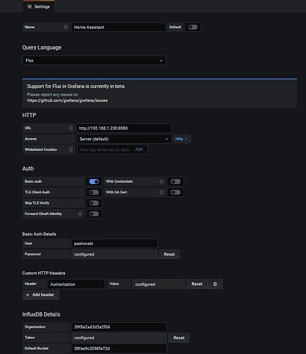

At one point I did get a green light, by following this great post by Ivana Huckova. But, when I tried to add a dashboard the graph had a little red exclamation point in it. And, Since All configuration of 2.x is through the web frontend of influxdb, Not through rest calls, I can’t use the CLI.
Cans someone tell me exactly which details go into which fields?

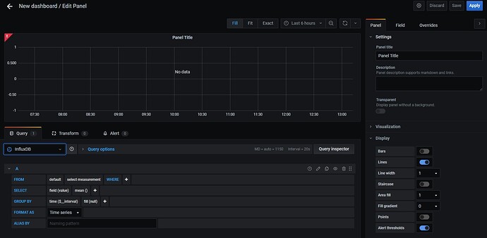

Well I just changed the Query Language to Flux and I can’t tell if that made things worse or better. Firstly it added 2 data sources. Now I have 2 databases to choose from, both are giving me problems for different reasons.
The first is just the standard red exclmation point.
The second one has no exclamation point, but all the fields are blank
I did noticed when I used QL , that when I added the source and clicked “save and test” it said 3 buckets found.
Next I went back to the data sources, and scroll to the bottom of the configuration, I am still getting InfluxDB Error: Bad Request
One thing I want to point out is I don’t know what specifically is supposed to go in which fields for this setup:

  • In one of your screenshots you’ve turned on Basic auth and you have configured a token and you have a custom header. I know you were probably just trying things out, but I think that Basic auth and the custom header should not be necessary. Can you try just setting the token? As a rule of thumb, unless you have a specific reason to set the datasource settings a particular way, it’s fine to leave defaults/blank fields.

I did exactly as you said - just setting the token and this - and it said three buckets found! When I hit “back”, I now see 2 data sources; “InfluxDB Default” and “Home Assistant” .

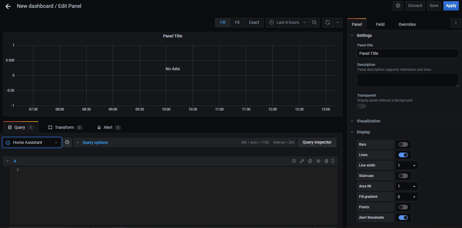

But, when I go to dashboards, there’s that red exclamation point in the upper right corner saying InfluxDB Error: Bad Gateway .

I think I figured it out, and if I did, then it turns out that it was working fine after I followed the advice here. While I don’t have the old option of adding fields, selecting measurements etc, when I picked a sample query, I saw all my data. If that’s the case, I guess that’s a win.
Am I correct that in this new version I have to type out everything I want?
Yup, that sounds about right. The visual query editor for Flux is still an open issue on Github, so indeed, for the time being you need to compose the raw query.
