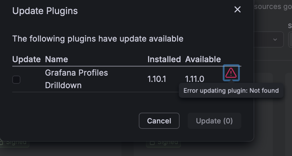

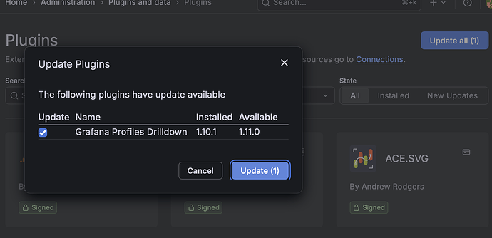

The update button doesn’t currently reflect that plugin admin has been disabled, so it will still look like the user will be able to update via the UI:
If I attempt to install the API request does fail as expected because the routes to update are not available when plugin admin is disabled:
Hopefully that covers your needs, and let me know if you have any follow up questions.
