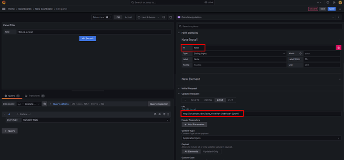

I did a small POC to do troubleshooting and show you:
First, the dashboard and the plugin config:

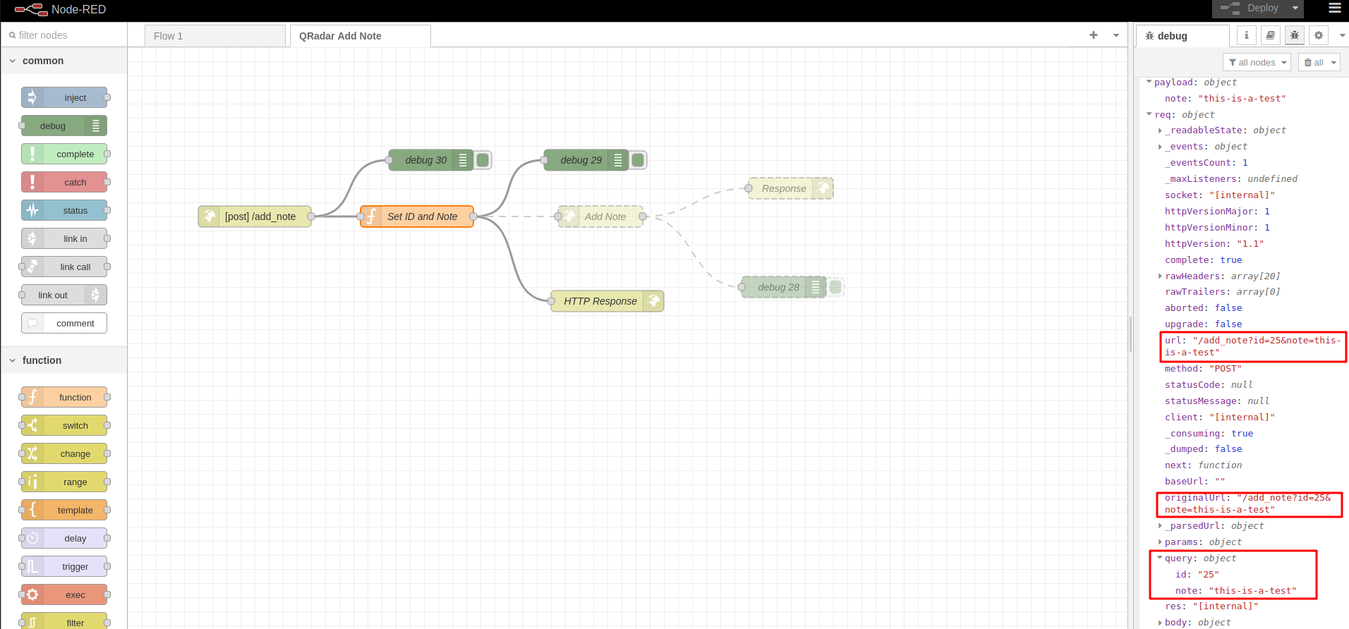

Second, the received information in NodeRED when I press “Submit” button:
As you can see, my expectation is to receive “this-is-a-test” as the value of the “note” field on “query” and on “url”, but I’m receiving “${note}”, and I’m only getting the value “this-is-a-test” in the payload and in the “note” field in the body of the HTTP POST Request.
As an additional test, I added a Grafana’s variable to the URL, with the name “id”, and put it a hardcoded value in the dashboard, “25”, and is working as expected (I get “25” as the value of “id” field on “query” and on “url”.
Am I understanding something wrong? Or something is not behaving as expected?

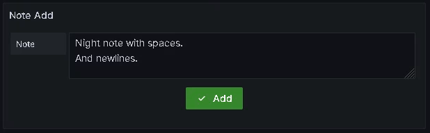

Abusing of your good will, I add a question here: how is the Data Manipulation plugin, in particular the Text Area Type field of a form element, managing the new lines?
Because when I add a note from Grafana, via API, to the end application, I’m loosing the new line:
On NodeRED, I can see the new line in the payload of the message, in the form of “↵” (which is replaced “visually” if I do a click on the payload with the newline), but in the URL and on the query field is erased (not even replaced by \n), while spaces are replaced by %20:
Sorry if this question is more referred to the way that Javascript replace the ${body["note"]} in the URL, and not mainly to the Data Manipulation plugin itself. The question is to try to understand, because I’m not a Javascript Developer, I’m just a script kiddie with willpower, :cry:
