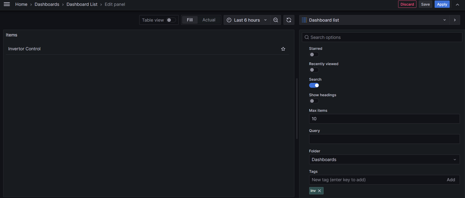

May be Dashboard list and filter by tag would fit your needs?
