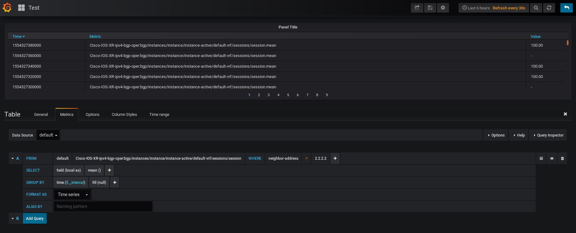

Thanks for your answer, I tried table panel but I only can view numeric info, I attached the screen capture.
When I change the query for a value like connection-state that isn’t numeric it says no data to show. Maybe I need to change some options?
I suspect that by telling it that you want the mean value of the field it probably takes that as an indication that it is a number. I am not sure what you expect if you ask for the mean value of some text strings that are not numbers.
  • Change FORMAT AS: Time series to FORMAT AS: Table
  • Select all fields/tags field(*) in your query
  • Don’t aggregate (no GROUP BY)
