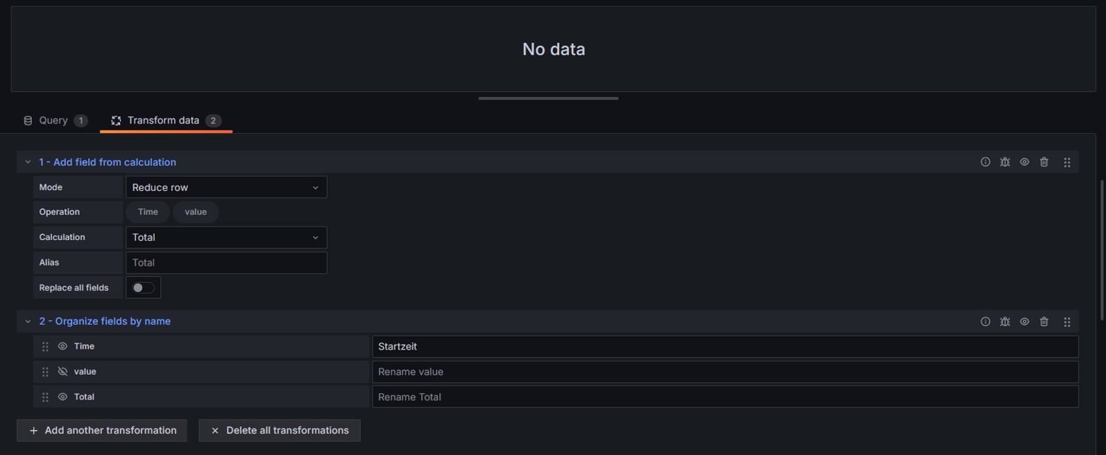

interesting, your example shows exactly what I tried to achieve. Unfortunately, for the moment, this doesn’t work for me. Here is my example:
Query:
Result without transformation:
and with your proposal:
I can see that there are different names: _time and Time
Did you achieve this in a stat panel? Maybe you could expand your query and your first transformation?
Thanks so far

what is causing the No Data? if there is no data its working as designed
Finally, I could achieve my goal. The (probable) solution was two steps:
  1. Check “Replace all fields” in the first transformation (reduce rows)
  2. Select “All fields” in the value options → fields section of the panel
Thanks a lot!
