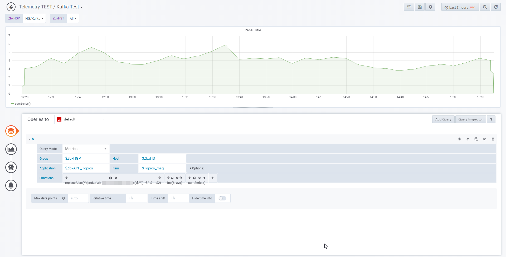

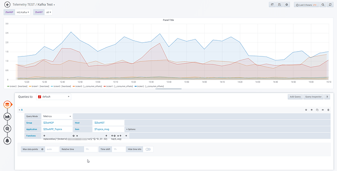

I can have all the separate items displayed without issues on a same graph with a single query.
But I can’t figure how to differentiate TopicA/B/C when using sum().
Any advise would be greatly appreciated.
