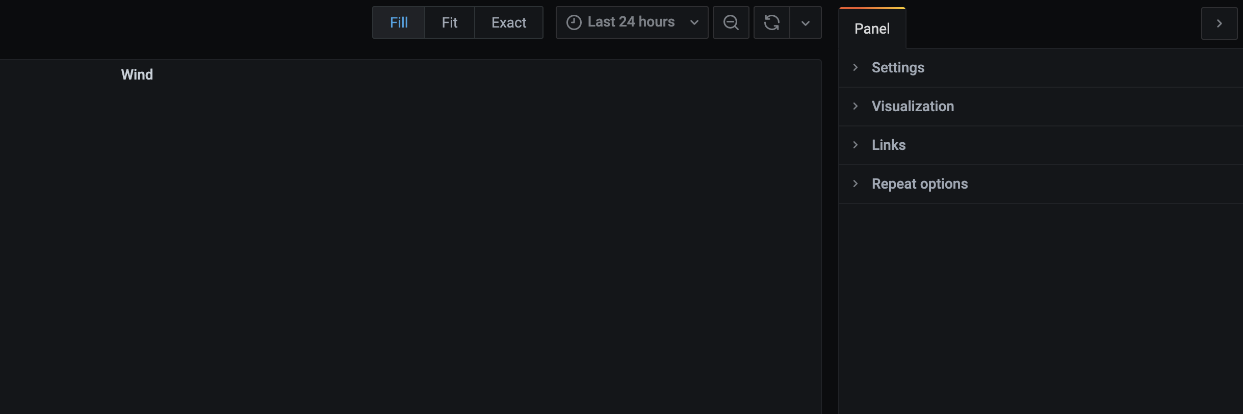

Hi, I’ve been using the WindRose plugin on a standalone Grafana instance (7.3.7) and have the following options available to configure the visualization when editing the panel
However, running the same plugin on Grafana Cloud I no longer have the ‘Display’ tab available

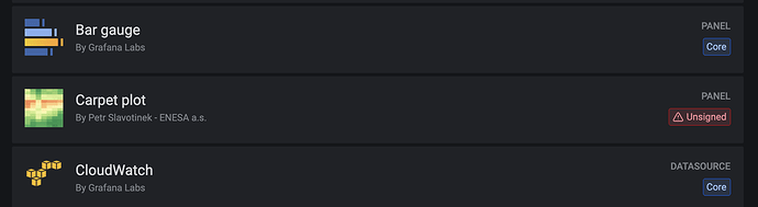

AFAIK, a plug in must be signed in order for it to work in Grafana Cloud. The Windrose plugin does not appear to be signed. Am sure you can contact the author and request it.
I will try to contact the author and see if that can be done, but I’m not sure if that is the issue here as I can successfully use other unsigned modules in Grafana Cloud
