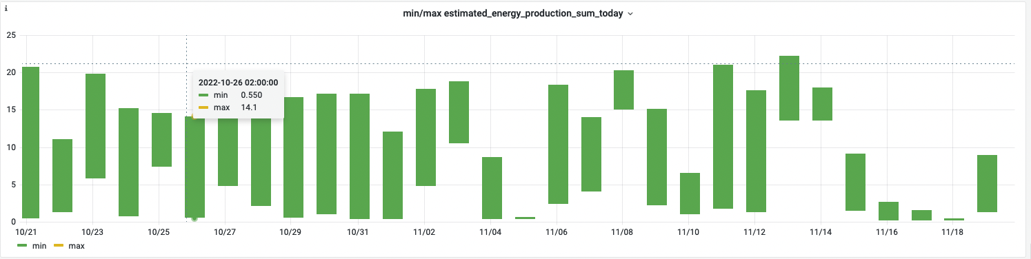

I need to get the min/max value of state for each day in the specified range.
I finally got around to this query:
SELECT
  local_date AS time,
  min(state) AS min,
  max(state) AS max
FROM (
  SELECT
    CAST(last_updated AT TIME ZONE 'Europe/Prague' AS date) AS "local_date",
    state::float
  FROM
    states
  WHERE
    $__timeFilter(last_updated) AND
    state not in ('unknown', 'unavailable', '') AND
    entity_id = 'sensor.estimated_energy_production_sum_today'
) q
GROUP BY
  local_date;
The expression CAST(last_updated AT TIME ZONE 'Europe/Prague' AS date) AS "local_date" converts the datetime from UTC to Europe/Prague timezone, removing the time and leaving only the date. The local_date is then used to do the aggregation and find the min/max. The resulting graph then looks like this:
Thanks again for your reaction.
