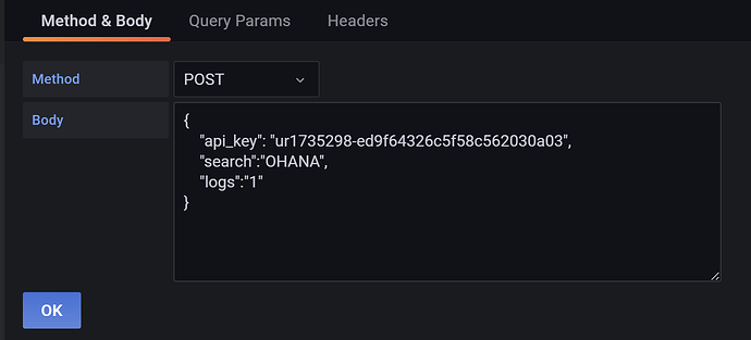

I am running Grafana in docker (latest) on Ubuntu 16.04 on a ‘shuttle’ mini-computer.
I want to display a state timeline for my external monitors.
I use a REST API from UptimeRobot through the infinity datasource.
I managed to get the result I wanted :

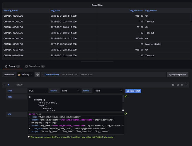

My problem is that I have to do one request per line, even if all the data I need is in one request.
In the JSON I get from the API, there is my 5 monitors, with different data for each.
In this data, there is a table called logs containing the timeline data.
The only way i managed to make the timeline work is by setting the monitor[i].logs as rows/root.
But by doing so, I can’t access the data from my other monitors and I have to repeat my query.
Is there any way to do what I want without repeating the query?
I don’t think I can put several values in the rows/root field, or display the timeline without setting my logs table as rows/root.
I want to expand this graph to more monitors but it doesn’t seem reasonable if I have to do one query per monitor.
Thanks a lot,
Best regards,
Thibault.
PS: I have been visiting this forum for months and it’s been extremely helpfull.
Thanks a billion to all the grafana community.

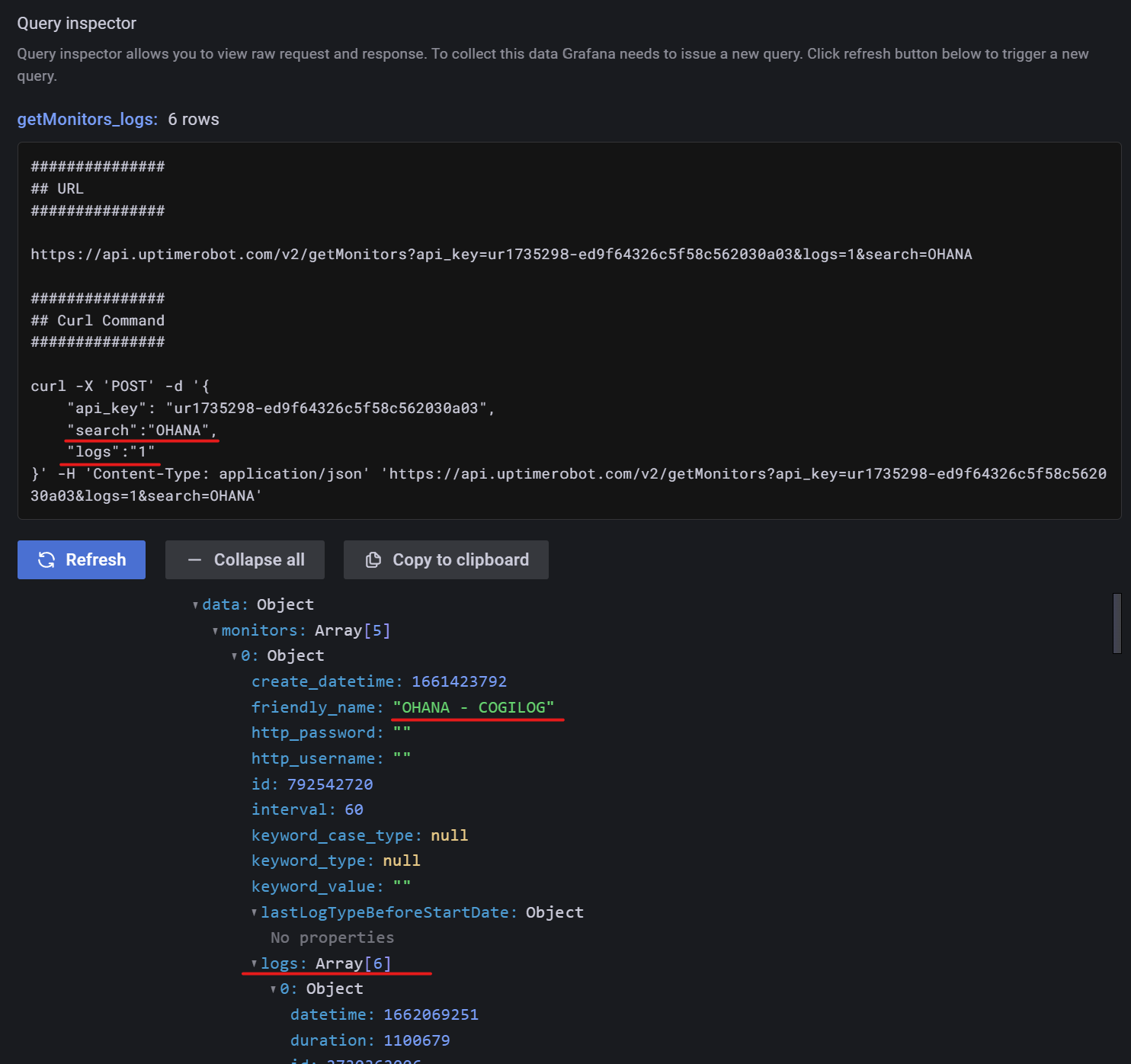

Could you please post the json data coming back from getMonitors?
Hi yosiasz,
thanks for the extremely quick response.
here is the json :

sorry for the delay
parses as invalid json. please vet json data on online json validator?
Here is a valid JSON.
thanks a lot for all your help.

use UQL and jsonata
parse-json
| jsonata "schema.meta.custom.data.monitors"
| extend "start"=unixtime_seconds_todatetime("create_datetime")
| project "type","start", "friendly_name"
Wow, thanks a lot for this, i will try it asap.
I have been trying to make it work with UQL and jsonata.
The input of the timeline should be logs.startdate and logs.type for each monitor.
This allows me to show up/down time sequence for each monitor.
but I don’t know how to structure my data with JSONata so that the timeline panel understands it.
I’ve been using this : JSONata Playground - Get familiar with the JSONata language to try and structure the data.
I ended up with this : schema.meta.custom.data.monitors.logs.[datetime,type]
but this still won’t be accepted by the panel.
I am really gratefull for your help.

UQL can be enhanced like this to get each line of log item. Hope this gives some hint.
parse-json
| scope "0.schema.meta.custom.data.monitors"
| extend "create_datetime"=unixtime_seconds_todatetime("create_datetime")
| mv-expand "log"="logs"
| extend "log_date"=unixtime_seconds_todatetime("log.datetime"), "log_duration"="log.duration", "log_reason"="log.reason.detail"
# | project-away "keyword_case_type", "lastLogTypeBeforeStartDate"
| project "friendly_name",  "log_date", "log_duration", "log_reason"
# | summarize min("log_date") by "log_reason"
Thanks a lot!
I managed to get (almost) the result I wanted thanks to you both.
I used this :
parse-json
| extend "log_date"=unixtime_seconds_todatetime("log.datetime"), "log_type"="log.type"
| project "friendly_name",  "log_date", "log_type"
# | summarize min("log_date") by "log_type"
and a “prepare time series” tranformation with format : multi-frame time series.
I still have to rename the series but I will figure that part out.
My real remaining problem is that I used inline source with the json I provided you.
And I did that because when I switch to UQL type query, the query doesn’t seem to take my arguments into account properly.
Here is what I mean :
with json type query, the arguments are applied, i get monitors with ohana in the name, and the logs
but when I switch to UQL type query, I can’t get it to take the arguments into account
I have tried putting in my arguments as query params tab or as body of the request, nothing seems to work.
Any ideas as to how to solve this?
Thanks a lot for all your help!
Here are query inspector images to show you what I mean.

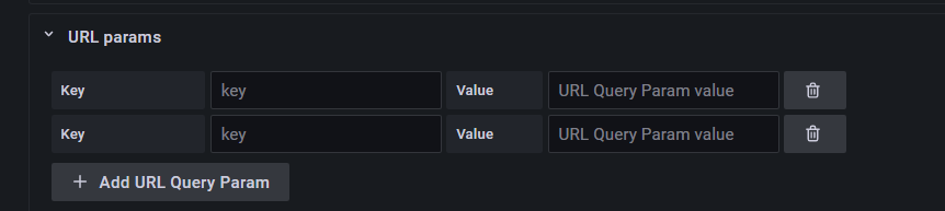

I have tried this :
and that :
i will try with the settings tab you pointed out.
Thanks
What you have looks like url encoded query. check this out
Thanks for your help!
I tried putting the arguments in the data-source definition as suggested but it’s not working either.
I tried adding them to the headers to just to be sure and it won’t work either.
I am quite stunned by the difference in behaviour between json-format queries and uql-format queries. Do you have any explanation for this difference?
