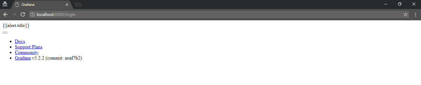

Hi,
If I launch URL http://localhost:8080 after setup ini file and started grafana-server, it is not properly opening grafana home page. attached the page that i am getting

i did that. There is no issue in server run and port connection. but full page is not loading. Something is blocking
When I start Grafana on Windows using port 8080 I’ll get a popup asking if I want to allow the application - I’m guessing you have sort of block somewhere? Could you please include the log when starting grafana-server?
