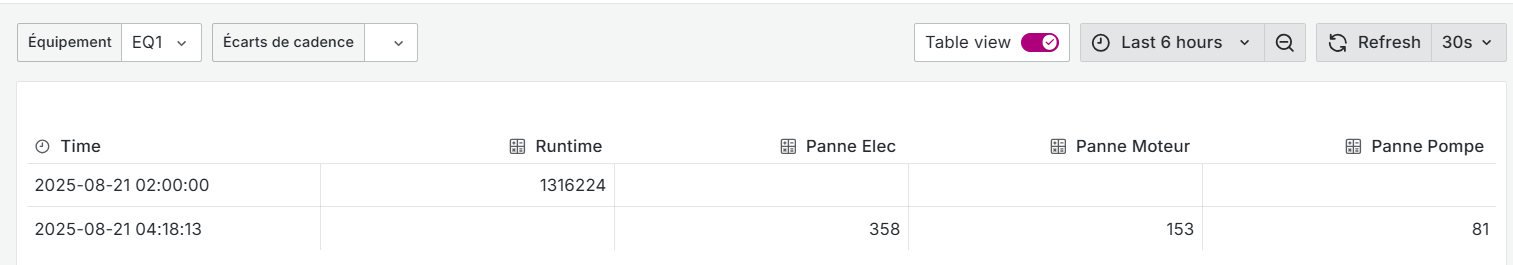

Yes sorry, I will give you better explaination :
Actually, I don’t start with a single row in my datasource. I have two separate queries from my datasource:
  1. Query “states duration” - Returns the runtime duration:
runtime
279132
  1. Query “states occurrences” - Returns multiple tables for each failure cause as occurrences:
Panne elec
80
Panne moteur
33
Panne pompe
18
The multi-row format I showed earlier is the result of processing these two queries through several Grafana transforms:
  • Original
  • Join by field (to combine both queries)
  • Reduce (to consolidate the data)
  • Transpose (to get the current format)
So the table I’m working with:
Field          | Value
runtime        | 279132
Panne elec     | 80
Panne moteur   | 33
Panne pompe    | 18
Is already a transformed result, not the original datasource format. My issue is that I need to replicate that single “runtime” value (279132) as a column across all the failure cause rows, but I can’t easily do this with the current Grafana transform options.
