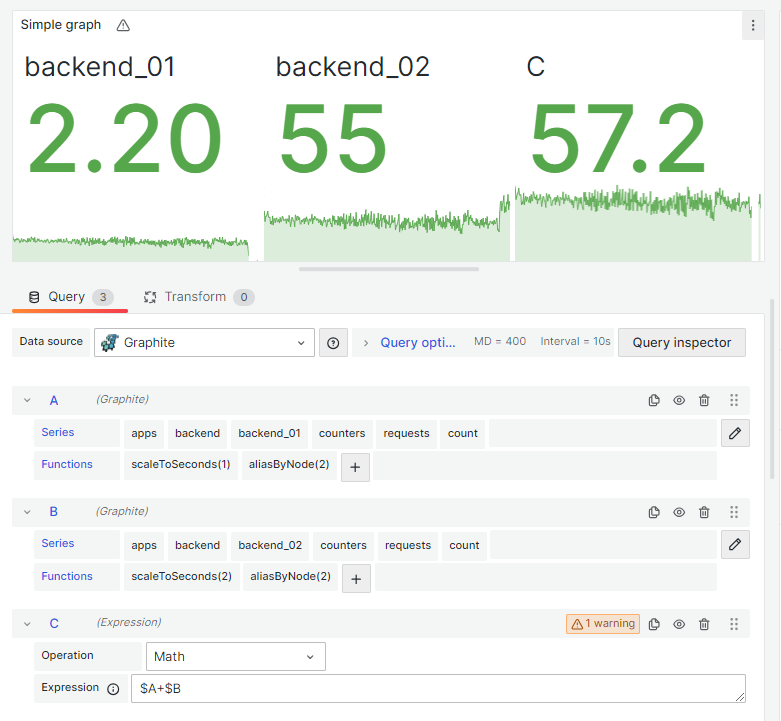

How about creating an expression like this?
Yes, need to sum both and get the total result.
also how to get output total in MB, GB, or TB as per the total sum value. actually, I want to measure total network utilization of the specific interface.
Were you able to successfully create an expression C as $A+$B?
You should also be able to do basic math (e.g. ($A+$B)/1000) and can select the units in the Grafana settings on the right (in edit view).
