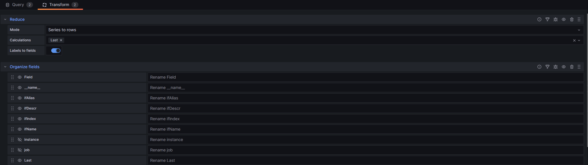

I think you could use following sequence of transformations (in order):
  1. Reduce
    This transformation will cause all of your result series to flat into single table (even from multiple queries). Note that default calculation is set to Max - if you’re using query of type instant calculation won’t change anything but if not - choose your calculation wisely (you’d probably be interested in Last or something like that). I also like to toggle Labels to fields.
  2. (Optional) Organize fields by name
    Reduce transformation might leave some mess you don’t want to display (like ifIndex, ifDescr, sysName). With this transformation you can toggle visibility of those fields.
  3. Grouping to Matrix
    Here, you can, as the name suggest, group the values into column / row matrix. For column, you’ll want to use __name__ of your metric, for row - ifName (name of your interface, if I read that correctly), for cell value - the value calculated from Reduce (transformation in step 1). With a bit of luck (on my side :smile:), you’d get what you want.
Perhaps, you might also want to use Fields Override with Value Mappings to change the value of ifOperStatus to more descriptive name (in your screen, there are up and down statuses).
Screen of my configuration below:
(don’t mind le label - treat it like your ifName label - I don’t have your metrics, I just used some prometheus function to change the name of my metrics). Also, if you don’t like the le\__name__ title of the most left column, you can use another organize fields transformation to change it.
Hope that helps!

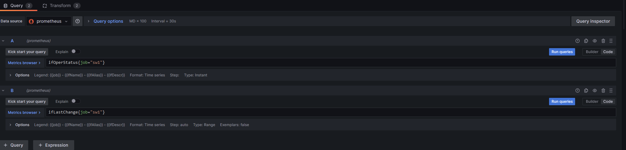

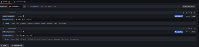

Those are my queryies

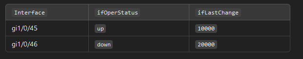

This is how it should looks like ( if you want i can make better picture later )

How to make table to be with 3 columns only having name of the interfaces at left and values from the query a and b at the right side

Right now you have both Column and Row set to the Metric field. Those two need to differ. Can you please remove Series to rows transformation, and use all three of the transformations: Reduce, Organize Fields, and Group to Matrix (they all need to be applied at the same time in the order provided)? In Group to Matrix transformation pick ifName as column and __name__ as row (or reverse that meaning ifName in row and __name__ as column). That should do the trick.
Am now this is the end result :smiley:
On the left side where are the name of interfaces, everything looks good!
But now every value has its won column ^^
You need to obtain the labels from your metric by toggling Labels to fields
Then you’ll have many more fields to choose from in Grouping to matrix. Column should be one of those fields (now you told Grafana to create a column out of Max field, so that’s why every value has its own column)
