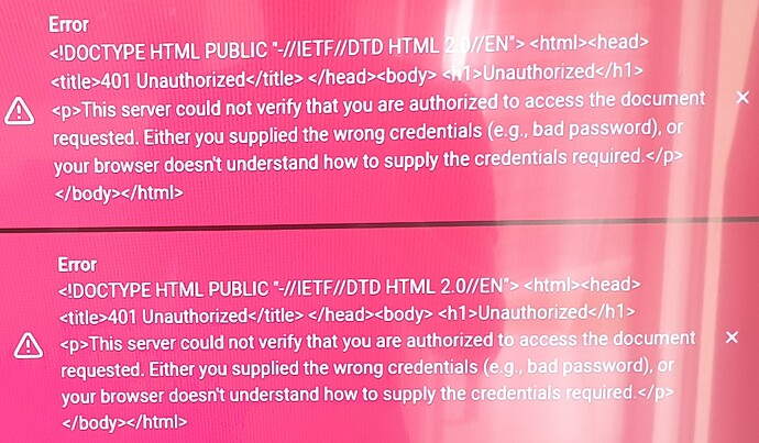

Hmmm, interesting… I have done some experiments and for me Grafana works on Tizen Browser ONLY when authentication is set to anonymous and there is no authentication in webserver. Otherwise I see this (attached image).
Maybe this Tizen Browser is simply too stupid to handle this way of auth?
It looks like it is kinda stupid and outdated.
Use Nginx and auth proxy to enable standard logging for external users and this kind of config mentioned above for only tizen agents. Also make sure you whitelist only certain IPs on both nginx and grafana.ini config, to ensure maximum security.
