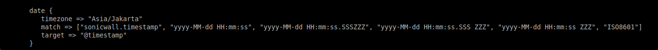

Put the filter in the date like below in the logstash filter
