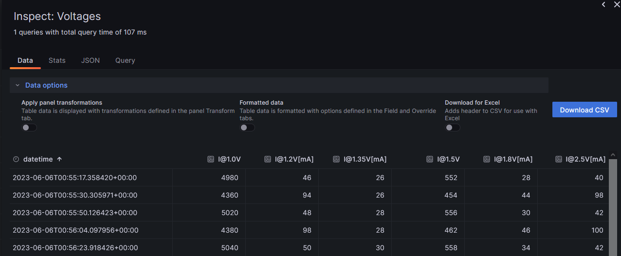

The data returned from the elasticsearch database is as expected and has the correct timestamps in UTC the first one being “2023-06-06T00:55:17.358420+00:00” so about 1am on the 6th of June UTC.

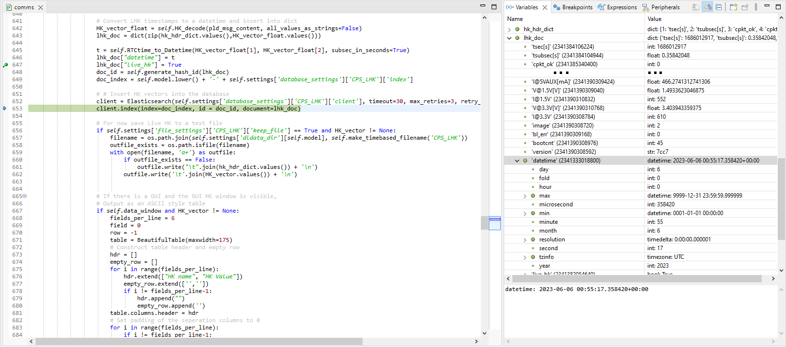

This is a screenshot of a debug session running the code which is about to push the data into the elasticsearch DB. This happens in line 635 (the current code line). The dictionary with contains the data to be pushed is called lhk_doc. You can see it in the variables watch window. The timestamp (key = “datetime”) is shown there as well and you can see that it is a timezone-aware datetime with tzinfo = UTC.
