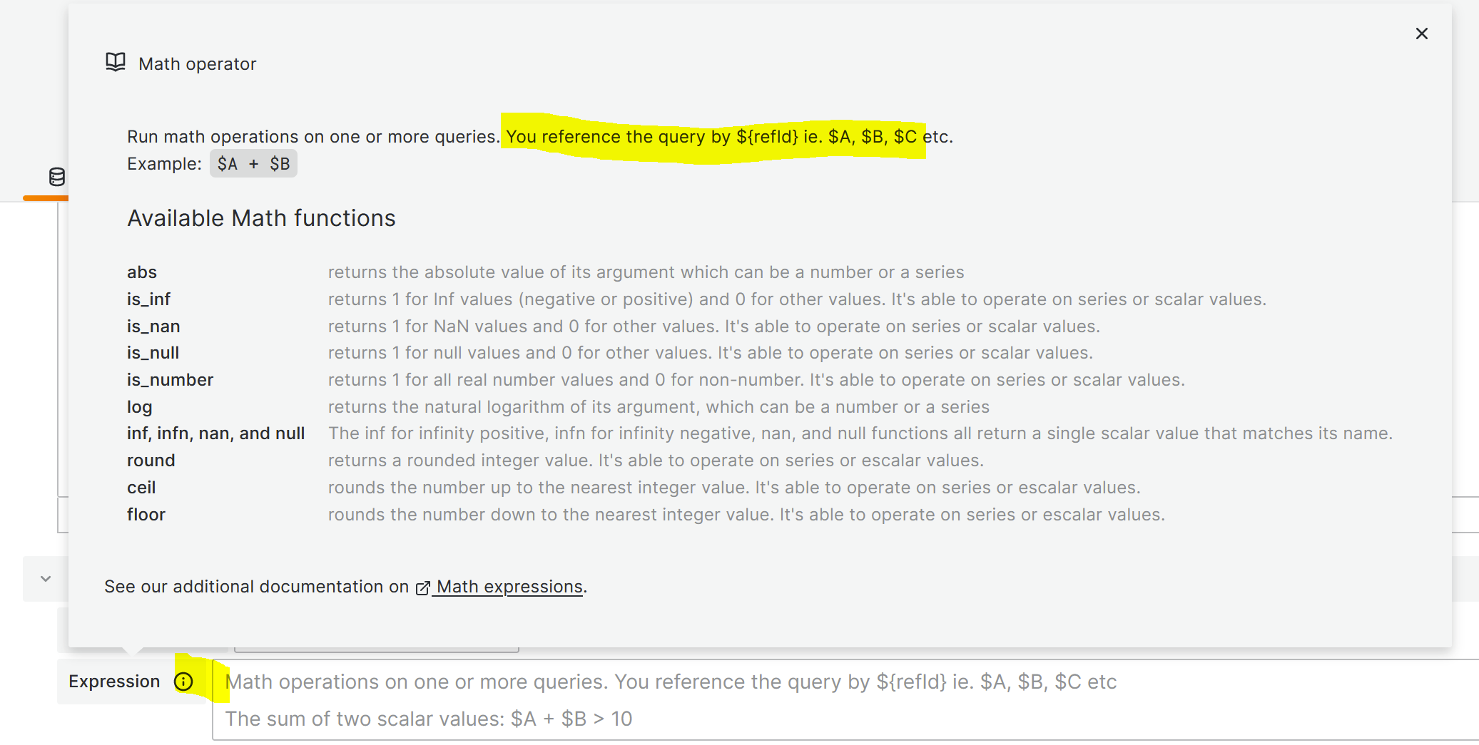

I tried this weekend to convert values in kelvin to celcius, using EXPRESSION, and I don’t understand, when I enter the formula, I have the datas which disappears from the dashboard.
I have tried different syntax on formula, same.
Grafana gives me an error that I don’t know how to interpret.
Check doc:
Are you sure that refid of your first query is temp? I guess it is A, when expression itself has B (but I can be wrong, because you didn’t show that):
Ha Ok, expression math only between refid. Yes my first query is A
I didn’t find anything in the transformation options, but maybe I didn’t understand
In this case what should I use to do temp-273.15, temp_min-273.15, temp_max-273.15 (convert Kelvin value to Celsius values)

So if you choose “replace all fields” then it will replace all fields and get rid of your locatiomln data in fact all data except the transformed data. So that is to be expected
I didn’t get there, so I got around the problem, by keeping the Kelvin degrees, and adding the Celcius degrees.
