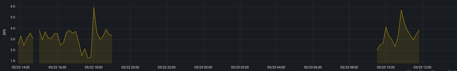

I have a time-series graph on my grafana.
If I have the Connect Null Values set as Always it appears this way:
If I set to Never it appears this way:
Is there a way to make the line continue on 0 instead of this breaks when the Never option is set or the connecting line that doesn’t show the correct value when the Always option is set?
The data comes from Elasticsearch and in some timestamps there are no results, so I need the line to stay continuous at 0.

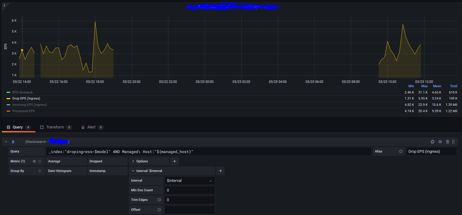

Here is the current config I have:
imagem
imagem
None of this configs work :frowning:

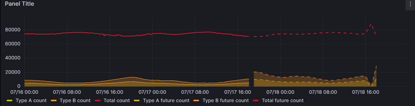

I have the same problem, I have two time series query to plot in the line chart with different time and the connect to null does not work and both lines start and end at zero which is undesired. Anyone found solution to this?

Could you provide an example of your current chart and the desired one? As well as some sample data.
@ebabeshko
I have two query A and B, A data is before current time and B data is after current time. I want to have solid line for A data and dash line for B data with stacking for Type columns. First figure is where I have stack charts but the values from A, B connect to 0 with null values which is not desired
I want to have the chart like below but with stack = normal

Something similar was raised here, although no solution was provided
@ ebabeshko yes, I saw the same post. Any recommendations/ suggestions for this from your end?
You’ve already opened an issue, let’s hope it would be fixed
