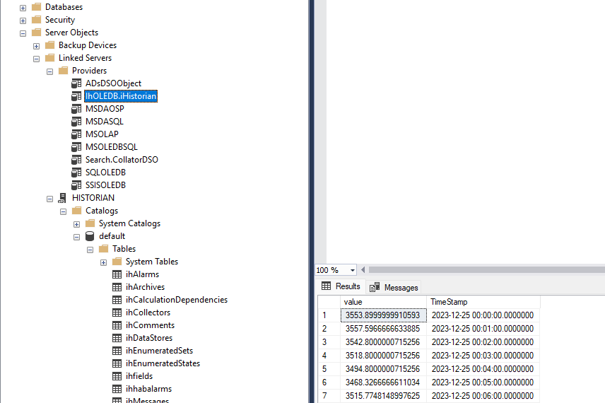

In the MSSQL managemnt it looks like below

I have now a connection to the linked server, the solution picture below
shows that you have to change the login to the linked server

The linked server
afbeelding
If i run the following query in SSMS SELECT * FROM [HISTORIAN]…[ihTags] i get all data
this also known as te 3 dot system
