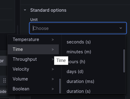

Did you try the option “Standard Option” on the right side of the panel?
If you go into “unit” it will open a drop-down list. Select Time from that and then select hours (h)
Let us know if this helps.

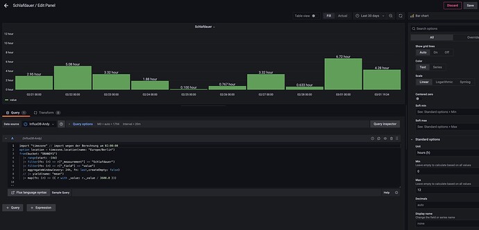

I set it up like this and my panel looks like this:

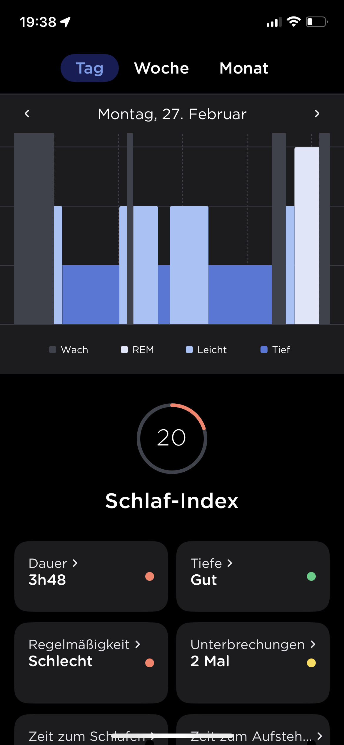

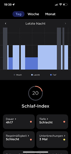

In my Withings app, the values look like this:
I think that’s going in the right direction, but the question now is how do I display the values 6.72 or 2.95 correctly, because an hour has only 60 minutes and so the display is of course 6.72 or acu 2.95 wrong. Do I still have to change the code and if so, what does it have to look like?

Here is some data that I have, which is in hours:
and here is that same data with the unit duration:(hh:mm:ss)
Basically, it thinks that my units were seconds, so 14.9 seconds gets displayed as 00:00:14.
Going back to my Flux query, I was calculating the elapsed time in seconds of a switch state being ON, and then converting it to hours using the map statement. Removing the map() function, we have:
Since the above values are in seconds, we can use the unit duration:(hh:mm:ss) and get this:
So long story short…build a Flux query that returns the value in seconds, then use the unit duration:(hh:mm:ss)

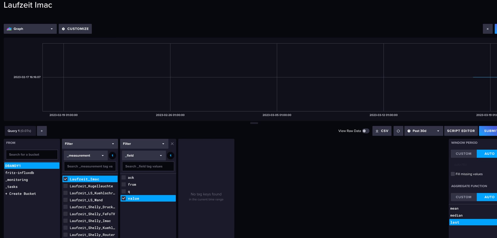

The values that I record are in Unix format. see the screenshot
@damrak2022
What is the unit of measure for these values? Newtons? Seconds? Minutes? Nautical miles?
I am trying to understand how the above output relates to your originally posted query, i.e.

Value is the duration a device is switched on measured in minutes.
OK, so if it’s in minutes, you need to convert it using a map() function to convert it to seconds, because (as I concluded in the original post above), you need your Flux query to return the value in seconds, then in Grafana use the unit duration:(hh:mm:ss). See below and see if that works for you.

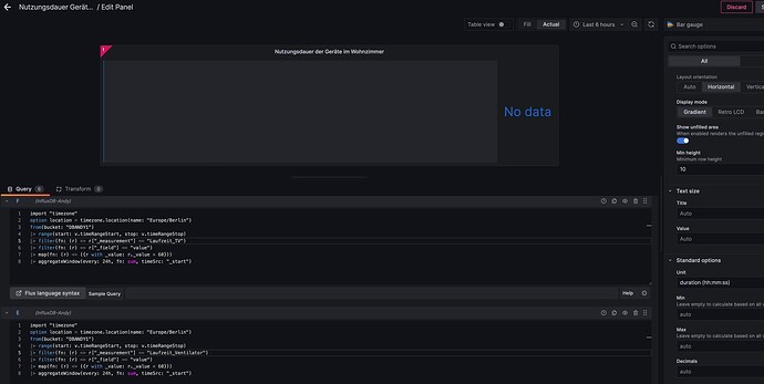

Sorry, it doesn’t work - see here:
If you hold the mouse over the red part, what is the error message?
This is the error message
invalid: runtime error: type conflict: int != float
