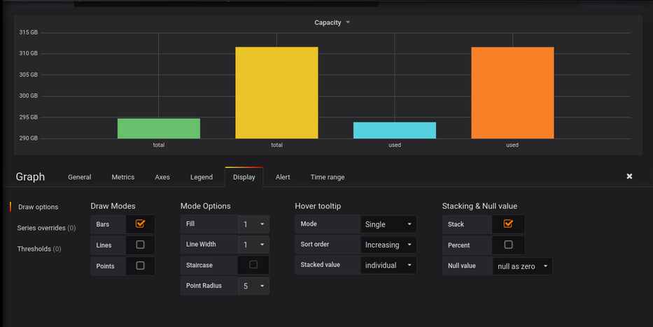

My usecase is i want a bar which shows used volume and remaining volume (2 queries)stacked in one bar itself. and like that there are multiple series.
But the values from query 2 don’t stack on the values from query 1, each query stacks individually, but i dont want that. can you tell me how to do this its urgent.

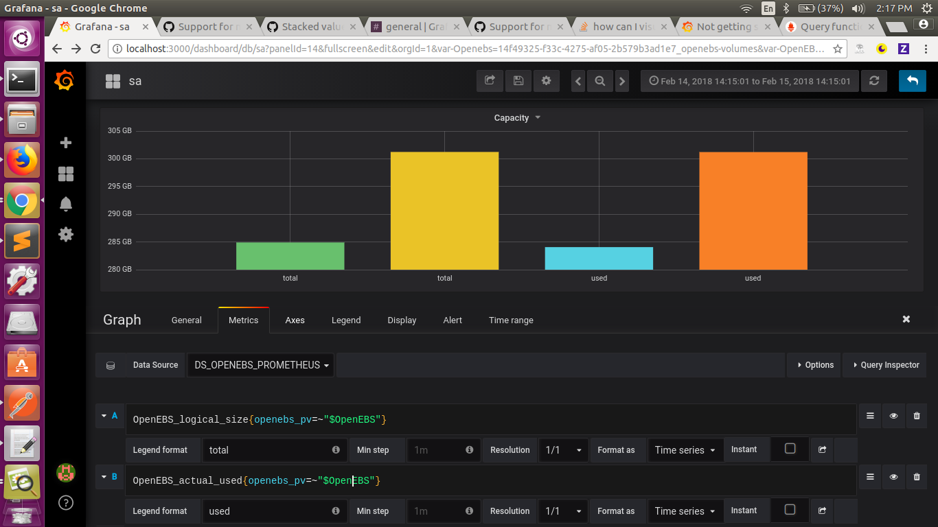

Yes my usecase is that. first i thought of using singlestat panel but that didnt work so i chose to go for graphs.

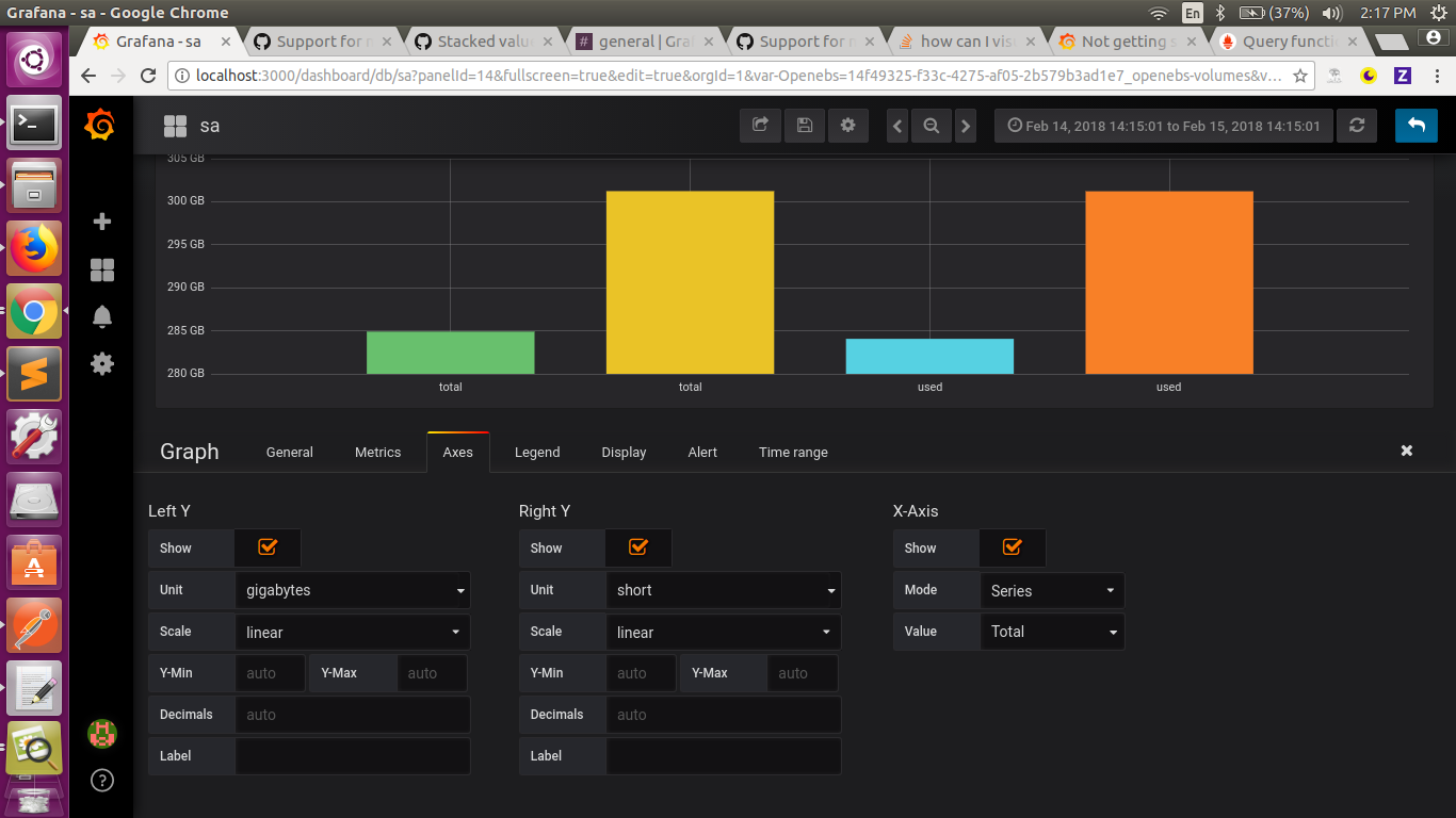

I want to display volume capacity for multiple volumes in a bar graph.
in which each bucket shows used and remaining. and like this for every series i want the buckets.
my queries are
OpenEBS_logical_size{openebs_pv=~“$OpenEBS”}
OpenEBS_actual_used{openebs_pv=~“$OpenEBS”}
Ah okay so you’re using X-Axis=Series. Then Grafana don’t supports stacking/combining values from multiple queries.
