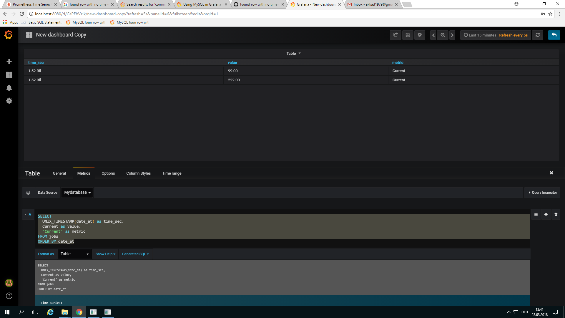

    now the problem is when i am trying to run this query
    SELECT
    UNIX_TIMESTAMP(date_at) as time_sec,
    Current as value,
    ‘Current’ as metric
    FROM jobs
    ORDER BY date_at
i am getting under the time_sec field somthing like this (1.52Bil) which is the a number in seconds i guess.

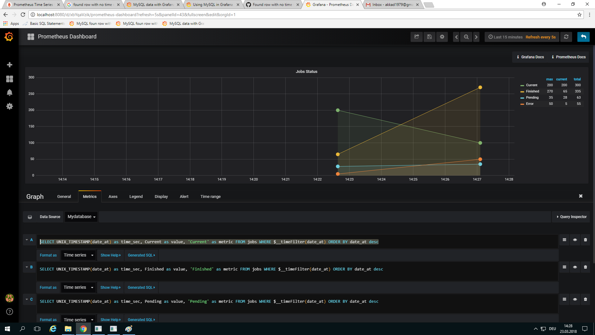

and when i am running the follwoing query
SELECT UNIX_TIMESTAMP(date_at) as time_sec, Current as value, ‘Current’ as metric FROM jobs WHERE $__timeFilter(date_at) ORDER BY date_at desc
so the graph is not showing the previous value of current. it shows just the last two points or values

Hi,
Please go to Column Styles tab and add time_sec to the Apply to columns named field, then change the Type to Date.
I don’t understand what you mean. Looks to me that you have no more data in the time range (upper right corner) you’ve selected. Can you provide something that visualizes what you’re trying to accomplish?
Marcus
