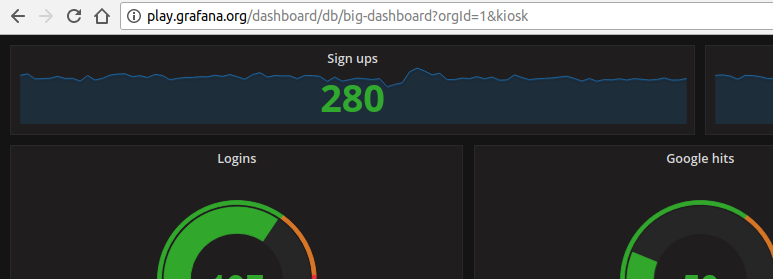

What version of Grafana are you using? They should be exactly the same. I tested on http://play.grafana.org/dashboard/db/big-dashboard?orgId=1 and I could not see any difference.
With &kiosk:
With d k:
