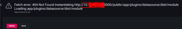

Install SWIS Plugin Fetch error: 404 Not Found Instantiating
Hi Floks,
I just new to this community.
I have try to using plugin swis-grafana datasourece to get data from solarwind orion for by follow step by step from this github
But when try to add datasource from gui alway get error like bellow picture

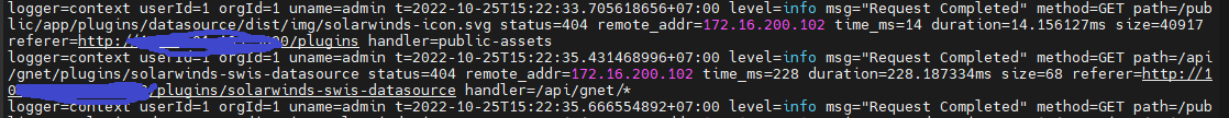

Here are error log,
Anyone has the same experince ?

Hi @nicolasdossantos248 The distribution files for this plugin don’t have a signature and grafana won’t load it unless you run grafana in development mode
