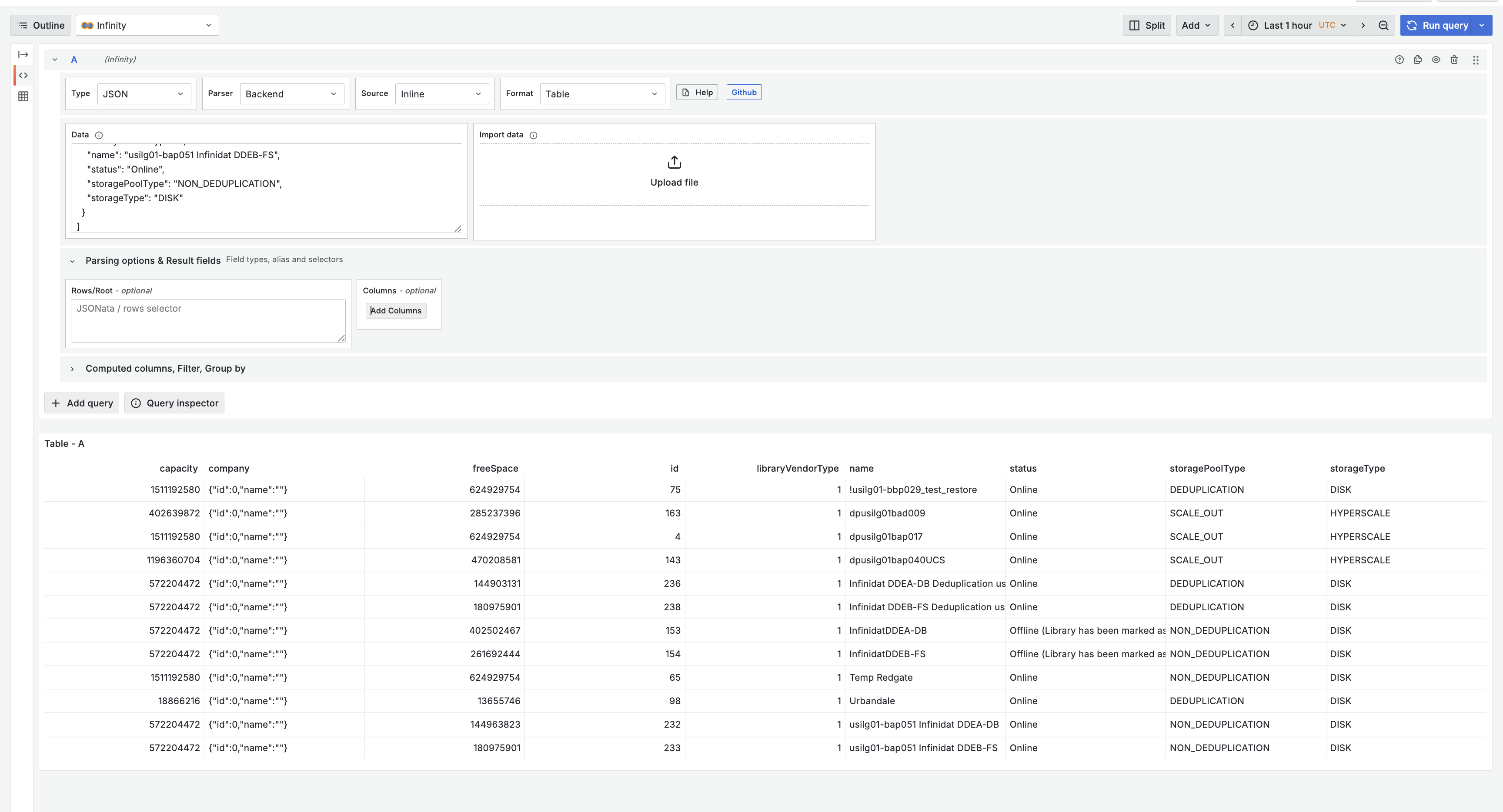

What Grafana version and what operating system are you using? Grafana v11.6.0
What are you trying to achieve? Trying to manipulate data received from CommVault
How are you trying to achieve it? I am using the Infinity plugin.
What happened? I am receiving the data, but I am having trouble manipulating it since it’s in one long string.
What did you expect to happen? I expected it to fit into a table
Can you copy/paste the configuration(s) that you are having problems with? Yes
Did you receive any errors in the Grafana UI or in related logs? If so, please tell us exactly what they were. No, I didn’t see any errors I have the data I just can’t arrange it to work with Grafana
Did you follow any online instructions? If so, what is the URL? No, not for this nor have I seen this problem before when using Grafana.
what does the data look like, can you post it here?
[{“capacity”:1511192580,“company”:{“id”:0,“name”:“”},“freeSpace”:624929754,“id”:75,“libraryVendorType”:1,“name”:“!usilg01-bbp029_test_restore”,“status”:“Online”,“storagePoolType”:“DEDUPLICATION”,“storageType”:“DISK”},{“capacity”:402639872,“company”:{“id”:0,“name”:“”},“freeSpace”:285237396,“id”:163,“libraryVendorType”:1,“name”:“dpusilg01bad009”,“status”:“Online”,“storagePoolType”:“SCALE_OUT”,“storageType”:“HYPERSCALE”},{“capacity”:1511192580,“company”:{“id”:0,“name”:“”},“freeSpace”:624929754,“id”:4,“libraryVendorType”:1,“name”:“dpusilg01bap017”,“status”:“Online”,“storagePoolType”:“SCALE_OUT”,“storageType”:“HYPERSCALE”},{“capacity”:1196360704,“company”:{“id”:0,“name”:“”},“freeSpace”:470208581,“id”:143,“libraryVendorType”:1,“name”:“dpusilg01bap040UCS”,“status”:“Online”,“storagePoolType”:“SCALE_OUT”,“storageType”:“HYPERSCALE”},{“capacity”:572204472,“company”:{“id”:0,“name”:“”},“freeSpace”:144903131,“id”:236,“libraryVendorType”:1,“name”:“Infinidat DDEA-DB Deduplication usilg01-bap051”,“status”:“Online”,“storagePoolType”:“DEDUPLICATION”,“storageType”:“DISK”},{“capacity”:572204472,“company”:{“id”:0,“name”:“”},“freeSpace”:180975901,“id”:238,“libraryVendorType”:1,“name”:“Infinidat DDEB-FS Deduplication usilg01-bap051”,“status”:“Online”,“storagePoolType”:“DEDUPLICATION”,“storageType”:“DISK”},{“capacity”:572204472,“company”:{“id”:0,“name”:“”},“freeSpace”:402502467,“id”:153,“libraryVendorType”:1,“name”:“InfinidatDDEA-DB”,“status”:“Offline (Library has been marked as Disabled.)”,“storagePoolType”:“NON_DEDUPLICATION”,“storageType”:“DISK”},{“capacity”:572204472,“company”:{“id”:0,“name”:“”},“freeSpace”:261692444,“id”:154,“libraryVendorType”:1,“name”:“InfinidatDDEB-FS”,“status”:“Offline (Library has been marked as Disabled.)”,“storagePoolType”:“NON_DEDUPLICATION”,“storageType”:“DISK”},{“capacity”:1511192580,“company”:{“id”:0,“name”:“”},“freeSpace”:624929754,“id”:65,“libraryVendorType”:1,“name”:“Temp Redgate”,“status”:“Online”,“storagePoolType”:“NON_DEDUPLICATION”,“storageType”:“DISK”},{“capacity”:18866216,“company”:{“id”:0,“name”:“”},“freeSpace”:13655746,“id”:98,“libraryVendorType”:1,“name”:“Urbandale”,“status”:“Online”,“storagePoolType”:“DEDUPLICATION”,“storageType”:“DISK”},{“capacity”:572204472,“company”:{“id”:0,“name”:“”},“freeSpace”:144963823,“id”:232,“libraryVendorType”:1,“name”:“usilg01-bap051 Infinidat DDEA-DB”,“status”:“Online”,“storagePoolType”:“NON_DEDUPLICATION”,“storageType”:“DISK”},{“capacity”:572204472,“company”:{“id”:0,“name”:“”},“freeSpace”:180975901,“id”:233,“libraryVendorType”:1,“name”:“usilg01-bap051 Infinidat DDEB-FS”,“status”:“Online”,“storagePoolType”:“NON_DEDUPLICATION”,“storageType”:“DISK”}
please post a valid json data using tools like https://jsonformatter.org/. Which data point do you want to extract and into what visualization
What error you are getting?

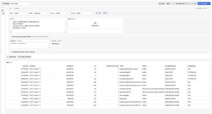

I am attempting to get exactly what you posted. When that data is imported it’s just one straight line of data. I have tried transformations to get it organized into a table but it hasn’t worked. The data I need is “Freespace” and “Name”
And I am not receiving any error.
Looks like the json data you posted is not you recieved.. looks like you need to add $.localStorage as root selector/JSONata under the parsing options.
Just noticed what I was doing wrong. This worked! Thanks!
