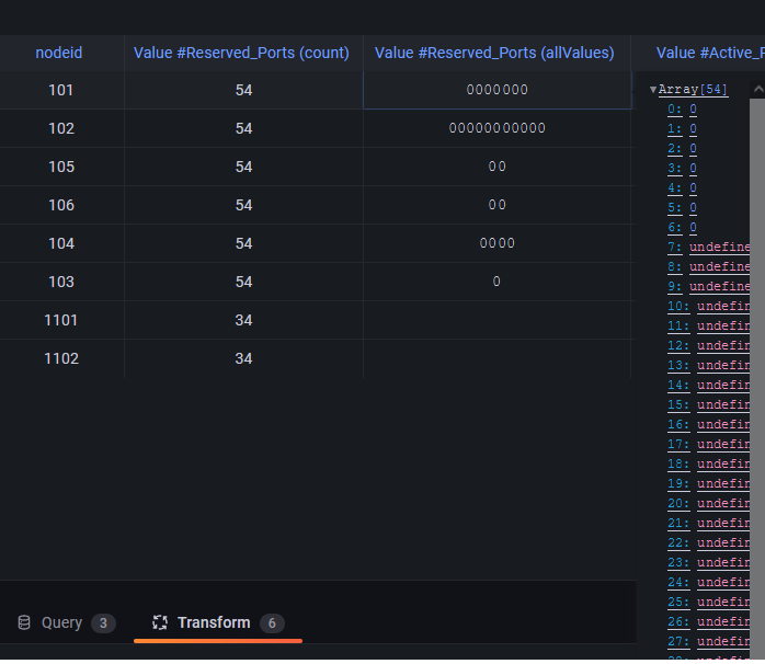

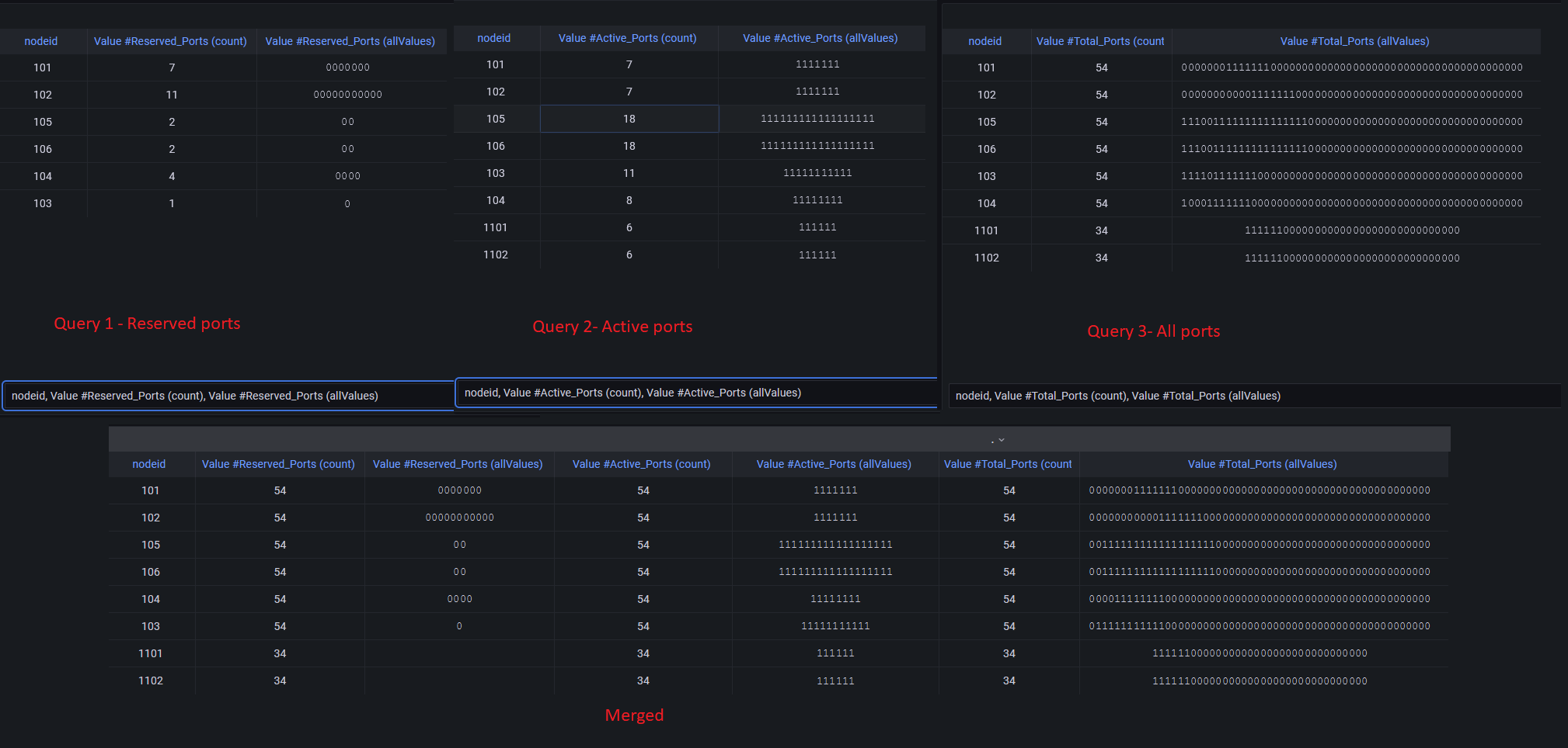

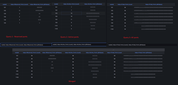

I’m running Grafana 8.4.7 with a Prometheus Database and cannot find a way to have count values of different queries in the same table dashboard.
I have three queries reporting ports status from switches :
  1. Reserved ports (admin status DOWN - value = 0 & label ‘description’ isnt empty)
  2. Active ports (admin status UP - value = 1)
  3. Total ports (Number of ports, regardless of status)
As long as I’m not merging, data from the three queries will be counted as expected, while on merged counters are incorrect
It seems to be caused by the fact that after a merge, the array is filled with ‘undefined value’ for every ports regardless of the query and is then counted
Is there a way to ignore those ‘undefined’ values from being counted, or any other method to have count from different queries in the same table ?

I’ve find a way to have the expected values in a single table by using ‘outer join’ transformation on ‘fabric’ label instead of ‘merge’ transformation, but I have to filter out a bunch of fields.
There might be a better way to do it !
BR
