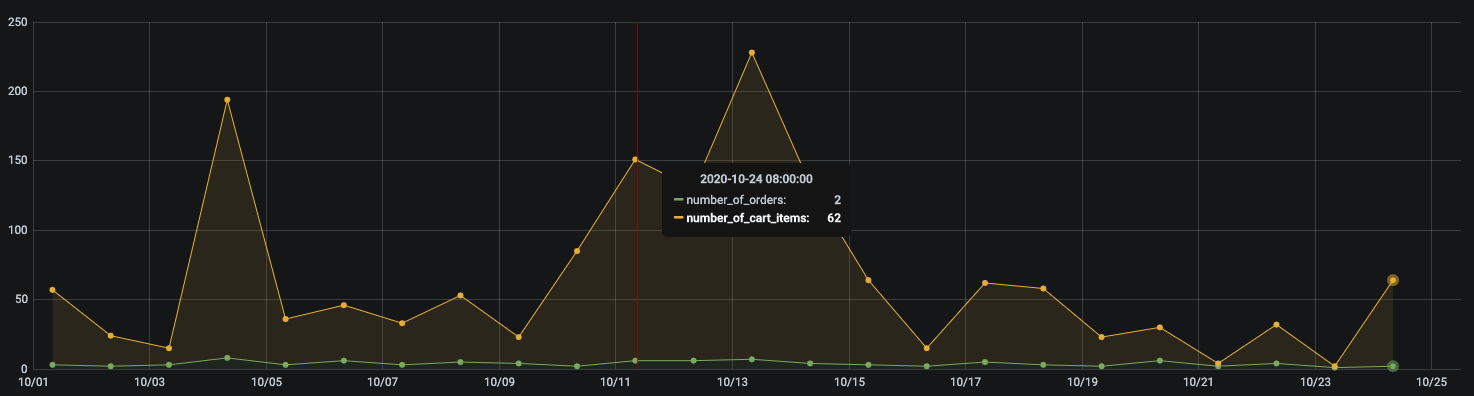

Also facing this issue using postgres plugin. When Hover tooltip is set to All series the values in the graph are not updated and seem to freeze at some initial value while hovering through the graph.
Using Grafana 7.2.0 with postgres 11
Example:
I just ran up against the same thing using the SQLite plugin. I had set up my time-series SQL query to order by time DESC, which was graphing correctly. I tried switching it to order ascending and the hover tooltip started working! Who would have thought.

Thanks, I had the same issue, ordering in ascending helped me :wink:
