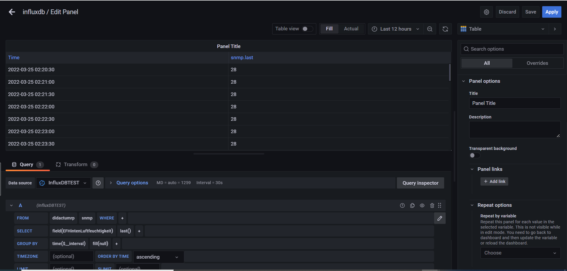

I am using influxdb and telegraf for collecting SNMP information from temperature/humanity sensors (Didactum Monitoring). I want to visualize it as Time Series graph but I get the error: Data is missing a number field.
If I visualize it as table it shows me date + value, so I dont understand why grafana cant visualize it as graph.

Debug it with the query inspector. I bet your last value is a string and not an number. "28" (string) is not the same as 28 (int). The best option is to check field type on the InfluxDB level.

this is solved by @jangaraj answer,
you need to have time and number as column type to be able to use timeseries panel
