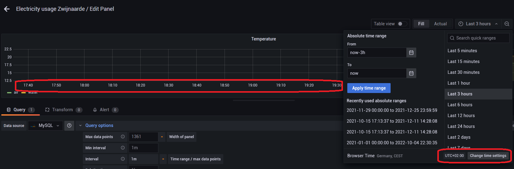

I am having trouble with the timezone offset in grafana.
I have a MariaDB 10 database with DB fields of type DATETIME I use as grafana time column.
I am located in timezone UTC+2 (CEST)
However in grafana when selecting tle latest 3 hours I get only 1 hour of data (see screenshot 1)
The filter in itself looks good when I inspect (inspection performed on 24/4/2022 19:25 CEST)
SELECT measurementtime AS “time”, sensorpurpose AS metric, celsius FROM temperatures
WHERE measurementtime BETWEEN FROM_UNIXTIME(1650810305) AND FROM_UNIXTIME(1650821105)
ORDER BY measurementtime
The inspection result in grafana however adds 2 hours to the time (see screenshot 2).
How can I fix this issue?

FYI: I have just tried switching from DB fieldtype DATETIME to DB fieldtype TIMESTAMP but this has the same result.
By using the UNIX_TIMESTAMP SQAL function I believe my database values are correct (see screenshot 1)
FYI: I have UTC+2 specified in the grafana time range popup. If I do this the times on the X axis are correct (see screenshot 2)

I can confirm I have had this exact issue. Took me forever to find as I’m new to Grafana (which I just love so far otherwise :slight_smile: )
From my testing the issue appears to be in the parsing of the variables when generating the SQL to query the DB. And also how returned dates are expected to be encoded (time zone wise) Here’s some debugging recreation info:
Ad the following to any Query on any panel:
DEBUG: FROM = ${__from:date:YYYY-MM-DD HH+mm+ss}
DEBUG: TO = ${__to:date:YYYY-MM-DD HH+mm+ss}
Note: I did not use capital HH for hours and got the US standard 12h time. Took me some time to get past that :wink:
Note2: Since : is not allowed by Grafana luckily + can be used in MariaDB to partition the time part. For some reason I ran into issues if I omit them :wink:
Save and use your dashboard.
Select a time interval. for example:
When the panel has reloaded click the title and in the menu select inspect > query
(had to remove image as I’m not allowed more that two images per post :crazy_face:)
You can now see what the parser has parsed as values for your selected interval. In my case:
DEBUG: FROM = 2022-04-28 00+00+00
DEBUG: TO = 2022-04-28 23+59+59
So far so good (hopefully) you get the correct dates to the parser and you can use them in your query.
Now, when the datetimes are returned in a recordset from the server, the datetimes are, in my case based on the system time zone, i.e. Europe/Stockholm. But it appears Grafana is expecting datetimes to be in UTC time zone and thus “converts” the raw datetimes in the recordset from UTC to [insert your selected time zone here]… I can somehow see this making sense as you would need it to be this way if you have several locations in several time zones looking at the same data. But, since my data is already in the local time format I need to convert the datetime to UTC before returning it to Grafana.

  • The first two rows shows the “raw” returned date from the DB, since it is explicitly cast as a VARCHAR it is not handled as a date by Grafana (apparently).
  • The third and forth row shows what happens if we simply return a date right out of the DB. Apparently Grafana “expects” all dates be UTC thus it converts the date to match the selected time zone as if they were UTC datetimes.
  • So since we have datetimes in Europe/Stockholm time, we need to convert them in the recordset to UTC before returning them to Grafana using CONVERT_TZ()
That way I get the following results, which I’m good with :slight_smile:
